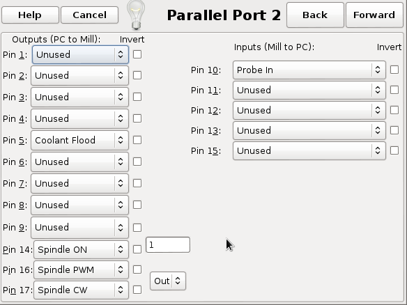

Not sure if this is a bug or user error, but I have noticed I only get the spindle configuration gui tab when I have the primary parallel port configured as a spindle speed control, but if I only have it on the second card, the tab does not appear.
I have split off my spindle speed control components onto port 2 because Im out of inputs on port1.
I can add it to hal with vi, but if this is a bug I should report it to help things improve yes?

Sorry, very vauge there by me, hopefully this is a bit better. I was still fishing to see if I had done something daft first and I got called away from the pc and hit send
From the inital header of stepconf (I tried a -v or --version flag but it doesnt have one.
# stepconf 1.1 revamped by Chris Morley 2014
The release is 2.6 on Debian Wheezy install
$ uname -a
Linux myhostname 3.4-9-rtai-686-pae #1 SMP PREEMPT Debian 3.4.55-4linuxcnc i686 GNU/Linux
$ python --version
Python 2.7.3
$ cat /etc/debian_version
7.7
I ran it in debug, with the parport configured onto port two and got this out of the -d flag :-
DEBUG: FWD search 4,pport2,Parallel Port 2,True,of 11 pages
DEBUG: page_set_state() spindle ,False
Attached screenshot of the gui which produced that output.
If I proceed further in it doesnt offer the spindle dialogue page.
If I enable a pin on the first parallel port as the spindle pwm, the dialog appears as expected.
Its not a showstopper, but it did cause me to scratch my head a bit at first thinking I was missing something obvious trying to rtfm & not understanding how to control the spindle correctly. I have a vfd with a diycnc frequency to voltage + control relay board feeding the analog input to the vfd with 10v if that is relevant in any way (dont think so.. )
For now, its going round when I turn it on, so thats a improvement
Are there any config files etc needed which might help further diagnosis?

Thank you for the bug report.. I am pushing a fix for 2.6 on up now.
If you are using 'official' 2.6 it will come to you when 2.6.8 is released
The spindle signal check only checked the first parallel port - now it checks both.
ok well it will be a bit longer i see there is another incorrect check for spindle encoder signals....

Thanks Chris, I am in no rush as because of my odd spindle drive config Im having to hand edit things, but some people in IRC have handheld me through my first brush with hal directly and Ive started to understand the config so just passing it back as a noted.
