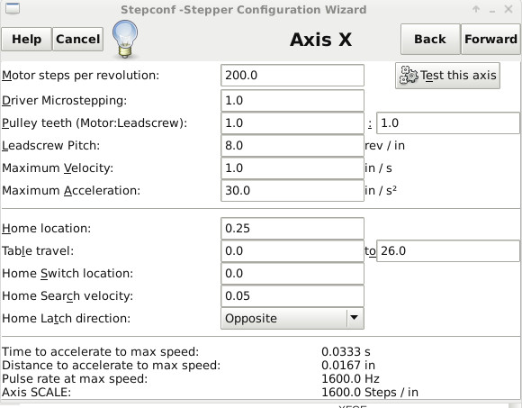

I have hermes engraving machine I'm working on converting to a CNC router, and all is going fairly well. I've finally wired the limit/home switches the way I meant to do it the first through fourth attempts and the noise problems I was having have gone away for the most part. Now I'm having trouble with the homing routine, the Y and Z axis behave appropriately but the X axis is searching for the limit switch in the wrong direction and then moving to the home position in the wrong direction. Below are the values I've entered in the stepper configuration wizzard.
The machine is a gantry type, when jogging the machine manually a positive move moves the head to the right, a negative move moves the machine to the left. I'd like to set the home position at the furthest point to the left, which is what I believe I have entered in the stepper configuration wizzard. When I start up the machine the z axis homes properly, then the X axis moves in a positive direction, to the right, it will hit the limit switch then back off until the switch releases then move to the right again to the home position, which puts it back on the limit switch and causes an alarm. I can touch the limit switch with my hand when the machine is inbetween the limit switches and it will stop, reverse directions then when I release the switch it will move to the right .25" and stop, everything seems to be correct except for the direction the machine moves searching for the home switch.
I've tried changing the home switch location to 26 and the home to .25 and it works properly, but it's throwing off my groove, I don't like having to move across the entire axis to get to the home position. Does the software always have to search for the home switch in the positive direction?

Have you tried putting a minus sign in front of home search vel. ie -0.05 ..Clive

As Clive says, depends on the sign which way it goes.
www.linuxcnc.org/docs/devel/html/config/ini_homing.html
You will find it easier to edit your ini file in gedit, rather than keep going back into stepconf and risk messing up all the other settings.

Thanks for the help, using a negative sign accomplished what I needed.
