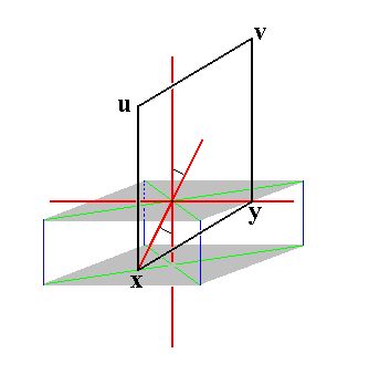

Hi guys,
am trying to build a hotwire machine.
I see alot of chats on this forum about the kinematics, i would like to know what is it about and how we can make our own?
from what I saw online, both google and this forum, the axis
X - usually refer to the left side of the machine (moving front and back)
Y - right side of the machine (movement front and rear)
U - Above X axis (moving up and down)
V - above Y axis (moving up and down)
My questions is, if we use the normal stepConf to setup a 3axis machine, then we change the mill.ini file to become 4 axis XYUV machine, what else do I need in order to run this correctly?
also, what to change for the gui to display correctly?
and what cadcam programs are there on this forum is using?
i did check out devFoam and it seems pretty easy to work with.
jz need more reading and information as I am already in the mid of it =)
Is there some examples I can see online or from this forum?
please point out to me.
thanks! =)

First have a look at the simulator config in sim/axis/axis-foam to see the neat foam-cutter preview mode.
Then have a look at the INI file to see how it differs from a normal 3-axis config.
One surprise might be that LinuxCNC sees it as an 8-axis machine, because the "last" axis is V. (XYZABCUVW)

X and Y are the axis for one end of the wire. U and V are the two axis on the other end.
I think the latest 2.7 pre version also has foam cutter setup support in Step conf. I've tested it and it works like a charm on my foamcutter (replacing the frensh software).
Cheers!

Stepconf can't create a foam machine however in 2.7 there is an Axis simulator for a foam machine.

Hi Sir,
when you say this the below:
"Hi!
Cheers!
Bernie"
do you mean that
X is front and back
Y is above X (going up and down)
U is front and back (opposite of X)
V is above U (going up and down)
another question I have in mind while running through the .ini and .hal files.
I have set the HOME for these axis to be
X & U (far end is Home, 0)
Y & V (top end is Home, 0)
hence, with X & U, coming towards me is (+) axis, while Y & V (going down is (-) axis)
let me know this is correct?
- then my previously uploaded image of the XYUV is incorrect or are they versions of this?
- from the cad I am looking at (currently is devFoamPro demo) I see that X is horizontal, Y is vertical, U is horizontal, V is vertical, but this can be changed?
Another question is, if I have already set HOME for them using a limit sensor place as afore mention, then if I need to set another "start" point for G1 to use so I can start cutting, where do I go to set this "start" location?
Because each cut is different, I hope I can set a "start" point for my software to use, while the HOME position is already set.
or do I have to use offset?
Last question, regarding the GUI, how do I setup the view so that it is showing the correct "view" of the machine with regards to the setup of XYUV as above?
thanks sir!

i would say that this is correct , as you have it
home as you have is is not home or 0.0 as far as cutting is concerned , this is shall we say machine 0.0
you can move the axis to any point , say just 5mm from leading edge and then you can use the touch off button in axis
to set the 0.0 point for your gcode cut . say set X & U to -6.0mm at this point , this will then cut into the block and your 0.0 will be 1mm inside the foam
i set Y & V to 0 at a height in the foam being the centreline .
i set the chord of the wing in the x , and cut from the trailing edge all the way round back to the trailing edge this gives a good round leading edge needing little cleanup
