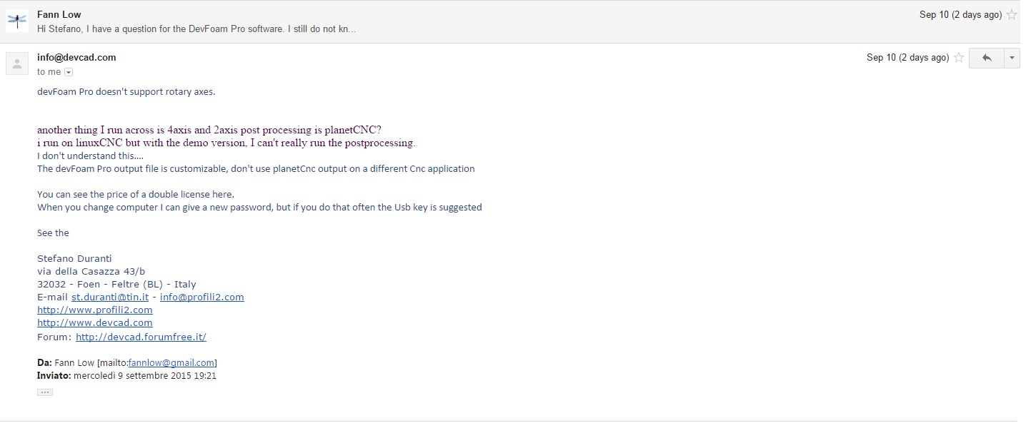

devFoam uses a post processor called the planetCNC
from the LinuxCNC Gcode References, it seems to me pretty much everything runs the same as with other Gcode...
is there anything I should lookout for?
devCam Pro ? (i use devFoam Pro demo for testing purposes)
I looked into the software for linear cutting and so far good job to say the least.
Kerf and everything else is easy to add onto the cut, even a 2-axis or 4-axis with the ability to choose the axis prior to doing any generation of codes so on..
however, as I spoke to the devFoam Pro representatives, they told me they do not currently support rotary.
not sure if this is the same cam software we are talking about?
i have attached my email conversation with devFoam Pro though..
so if its different, where should I go about modifying this post processor in devCam?
thanks
