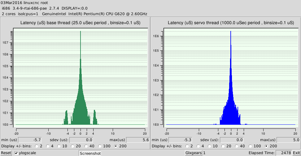

I thought 5100ns was pretty good jitter (just according to what I read on this site). I've only used isocpus=1 for a dual-core G620 cpu. I've done nothing else other than using an external graphics card. If I get that down to, say 3000, will that make a big difference? Thanks.

03 Mar 2016 12:15 #70958
Sorry, my mistake. Yes, 5100 nS is excellent. I was out by a factor of 10.
So, with a 5100nS latency but realtime delays on a 60,000nS base thread, something funny is going on. Maybe an infrequent issue that didn't happen during the latency test?
Have you tried running the latency-histogram?

04 Mar 2016 15:43 #71039
Replied by andypugh on topic Trying to optimize base period, etc.
You could try ignoring the warning and then see if anything bad happens.
I found that a CamView tab in Axis ruined my otherwise-good latency, so there are definitely things that can cause problems that don't show up in the test.
