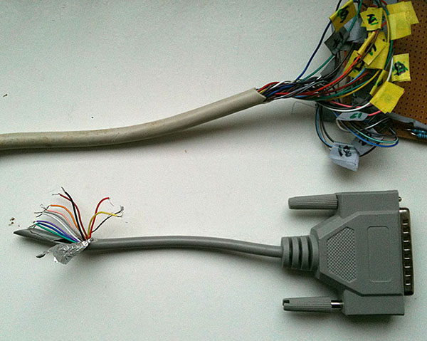

The cable in the attached picture (the bottom one) is being sold in eBay (UK) as "Parallel Printer 25M/25M Cable 3M - Switchbox DB25". It looked suspiciously thin (5 mm diameter) when compared to some worn and proven parallel port cable (7.5 mm diameter, on top). Pin signals were inconsistent, and interference was all over. Time for an autopsy.
Inside, surprise, surprise, only 11 teeny wires are to be found. These connect pins 2, 3, 4, 5, 6, 10, 11, 12, 13, 15 and 25. NO way this would ever work!
On top you see a corner of my new, extremely elegant ;-) breakout on stripboard.
I think I'll get some buffers for it, considering 74LS373 for the output pins, and inverter gates for the input pins (I've got opto-detectors at the limits, they raise the lines to 5V when triggered)
Still wondering how the parallell port card got to release the magic smoke: coincidence or not? I do not remember putting a high load on the lines. I am going to double-check the A4983 current needs, but it is supposed to be high impedance.
I am asking the seller of the cable, a computer parts shop, a full refund.
Greetings!

17 Jul 2010 10:47 #3390 by andypugh
My first thought was that it was a minimally-populated printer cable (and as such OK for the advertised purpose). But if the pinout you give above is correct then 3 of the 8 data lines are not connected so it would not even work for printing.
17 Jul 2010 13:38 #3391 by PCW
Looks like a serial cable to me...
17 Jul 2010 20:23 #3399 by lanthan
I double checked all of the wires. I confirm they connect to pins 2, 3, 4, 5, 6, 10, 11, 12, 13, 15 and 25.
It does not make sense for a printer parallel cable. Indeed, it would need at least all of the data pins connected, so 6, 7, 8 and 9 are missing.
A serial cable? But pin 10 is connected and it is supposed to be reserved, as per www.aggsoft.com/rs232-pinout-ca .
I think I have identified what it is: "Interlink and Windows 95/98/ME DCC parallel cable" as described here: www.lammertbies.nl/comm/cable/parallel.html .
So it would be a bad case of mix-up at the seller's. Unsurprisingly, it lacked any sort of labelling or tag.
17 Jul 2010 20:58 #3400 by PCW
Ahh, a LapLink cable. Haven't thought about those in years...
