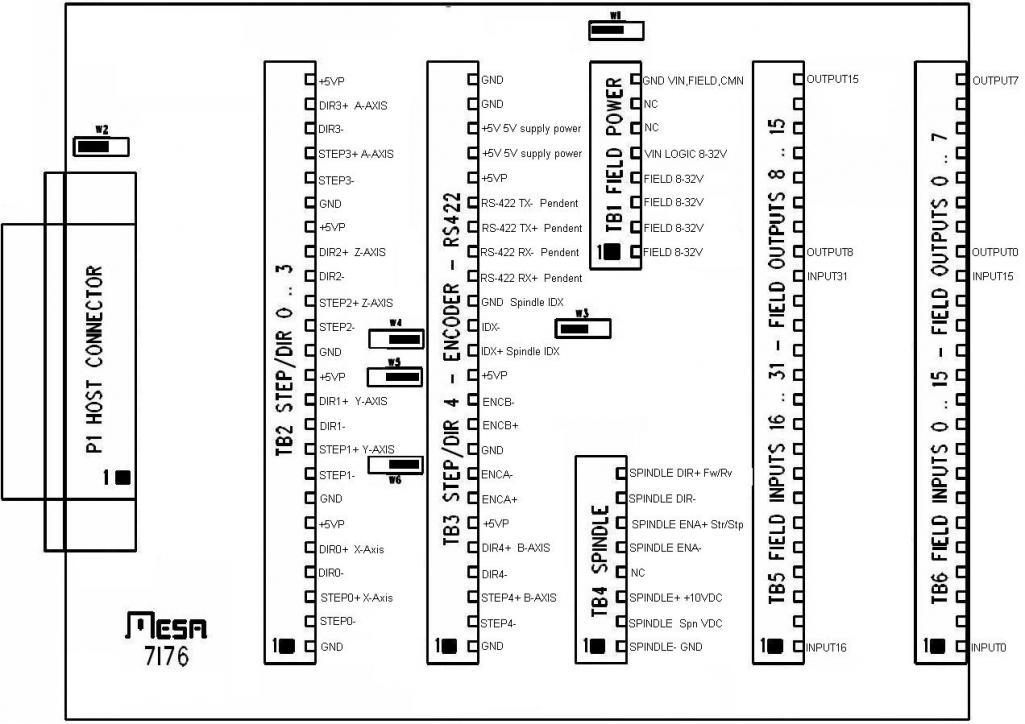

I am trying to control 3 motors with Leadshine DM556 Stepper Drivers and a Mesa 7i76 breakout board through a parallel port connection.
This setup was working prior to an architecture migration attempt which fubar'd the operating system.
Now with a fresh boot of Linuxcnc, I am trying to figure out the original stepconf which was lost.
Having reviewed the documentation of the 7i76 and the current configuration of the circuitry, I thought I had the pin settings correct in the Stepconf. So far I have been unsuccessful in controlling any motors during testing.
Anyone got any suggestions? Thanks!
PS
I have the 3 stepper drivers connected to pins 8-11 14-17 and 20-23 TB2 of the attachment.

Are you sure that this used to work?
The 7i76 connects to a 5i25 PCI card (or similar), not to a parallel port.
(I am not sure that it can't at least partially work with a parallel port, but this isn't its intended use)

Also, stepconf will not make a working configuration for a 5I25/7I76 card set (pncconf will)

With pncconf, I was able to move the spindle motor. Thanks!

The 7176 is connected to a Tormach Machine Controller Tower, with a DB25 cable.
Since Im just an intern there, Im very hesitant to crack it open to see whats on the other end in case I break something.

OK, that does explain things. Yes, Tormach use the 5i25 PCI card.
Is it a Tormach system? A fresh Tormach installation would be expected to just work, in that case.
