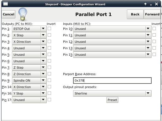

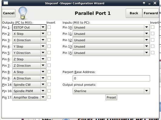

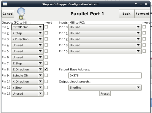

In the BOIS, the parallel port is set to SPP, but gave no indication what address it was on...
I've installed a fresh copy of linuxCNC 2.7.12 and all appeared to be going well - no errors.

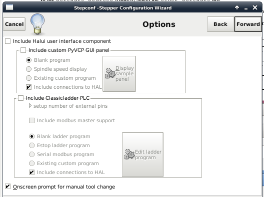

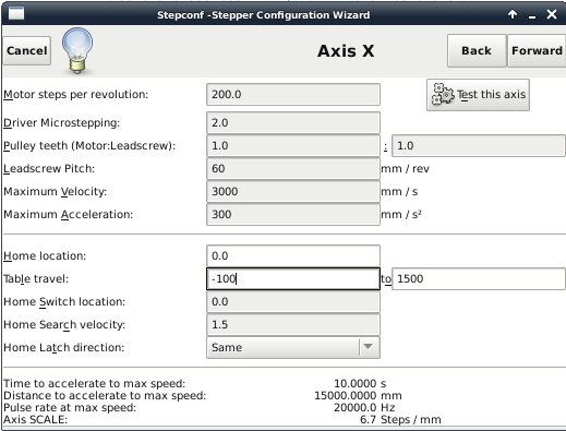

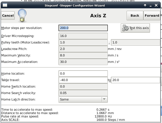

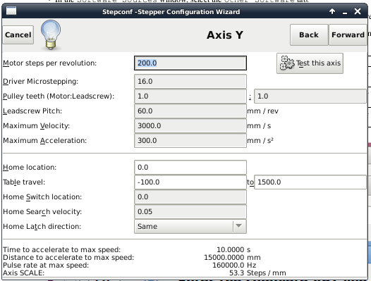

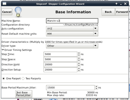

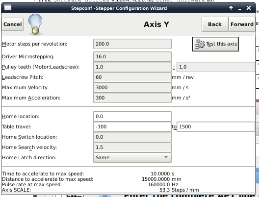

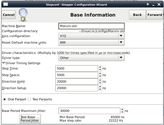

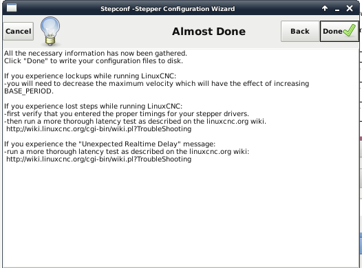

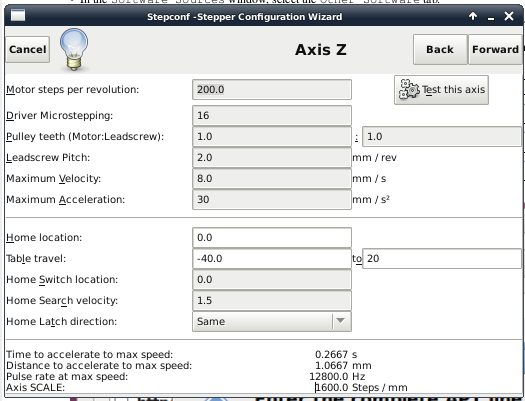

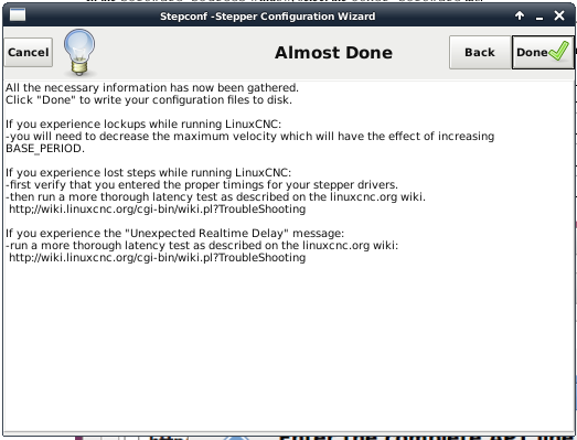

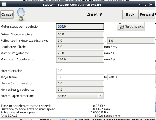

I ran through StepConf with the settings attached (these were taken from the previous machine)
When all is saved and I start the machine I get no movement at all.

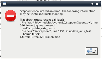

When I clicked the "test this axis" button I get the error attached - This did not worry me, as this feature did not work in my previous installation.
I have done some digging and wanted to start at the start, apparently lshw should tell me the hardware attached, but alas, I get a 'command not found', even with a "sudo" but I do get this...

From the command line you could try this command to try to find the parallel port address.
If nothing shows up the parallel port is probably disabled some how.
Do you have a backup copy of your old configuration. It should work with the new version of Linuxcnc with only minor modifications. (one line of hal code needs removed or commented out)
cat /proc/ioports |grep parportIf nothing shows up the parallel port is probably disabled some how.

From cat /proc/ioports |grep parport I get
0378-037a : parport0
..and from dmesg |grep parp I get
[ 11.100374] parport_pc 00:06: reported by Plug and Play ACPI
[ 11.100427] parport0: PC-style at 0x378, irq 5 [PCSPP,TRISTATE]
[ 20.127729] lp0: using parport0 (interrupt-driven).
and lsmod | grep parp provides..
parport_pc 21896 1
parport 35208 3 lp,ppdev,parport_pc
Which makes the port look promising.
Do I need to unload the parport_pc module or something?
I DO have a backup of the configs. What needs modifying?
Would it help to attach the files?

Interestingly, when I run the command loadrt hal_parport cfg="0x378"
I'm informed the "loadrt: command not found"
Am I reading legacy documentation?

Where did you type loadrt hal_parport cfg="0x378"?
(It won't work just from the command line, you would first need to start Halrun to get a halcmd prompt.)
To use your 2.6 parallel port config with 2.7 the only modification I think you need to make is to comment out or delete this line in your old hal file.
Why don't you give the old configs a try (with the nessisary modification) and if that still doesn't work, We will need to look more carefully at the error messages that are given when Linuxcnc fails to start.
loadrt probe_parportWhy don't you give the old configs a try (with the nessisary modification) and if that still doesn't work, We will need to look more carefully at the error messages that are given when Linuxcnc fails to start.

I've copied the file Marvin.stepconf and the folder "Marvin" to the configs folder on the new machine.
Then edited the file Marvin.hal.
I added a # at the start of the line with "loadrt probe_parport"
Saved and tried it.
Still no change.
No movement of the axis, despite them moving on the screen.
I've powered off ALL devices including the BOB, power supply, drivers and PC and restarted them all.
Stil no change.
I was planning on changing the location of the PC so have a longer and new parallel cable, so I've swapped this out too just in case.
No change.
In case it is helpful, here is the Marvin.hal file
My logic is now pointing at the BOB, but I'm no expert here - hence me asking for help
Are there any tests I can perform?
Many thanks for your persistence with this.

Yup, I have power from the driver power supply into the micro USB. This has not changed since it was last working a couple of weeks ago (when the PC died).
It is a ZP5A-INT Breakout board
(This shows what I have, the pic was taken when I was first setting up, hence the lack of wires to the drivers etc )
The is one red LED lit to show it has power.
Interestingly, there are no LEDs lighting when the motors *should* be running, that suggests it is either not getting a signal or not processing it.
06 Apr 2018 12:33 #108494
Replied by andypugh on topic Parallel port config? - probably
Start LinuxCNC from the command line (with the command "linuxcnc") and see what output you get.
But if the UI loads and LinuxCNC starts it sounds like the software side of things is correct. So i would start to suspect hardware (including the parallel port hardware).
There are some suggestions here: www.cnczone.com/forums/stepper-motors-dr...driver-problems.html that the enable signals might be problematic. Perhaps the new MB can't quite source enough current to drive the enables?
Does anything else seem to work? Inputs (limit switches) would tell us a lot.
The following user(s) said Thank You: Gr8funTargets
