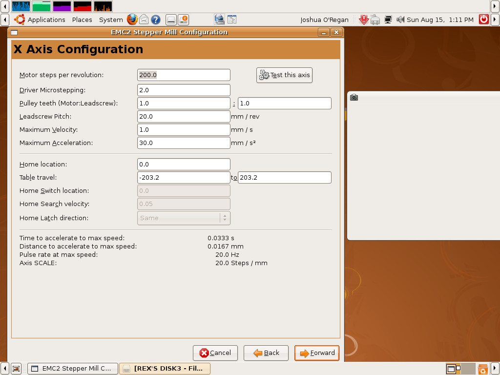

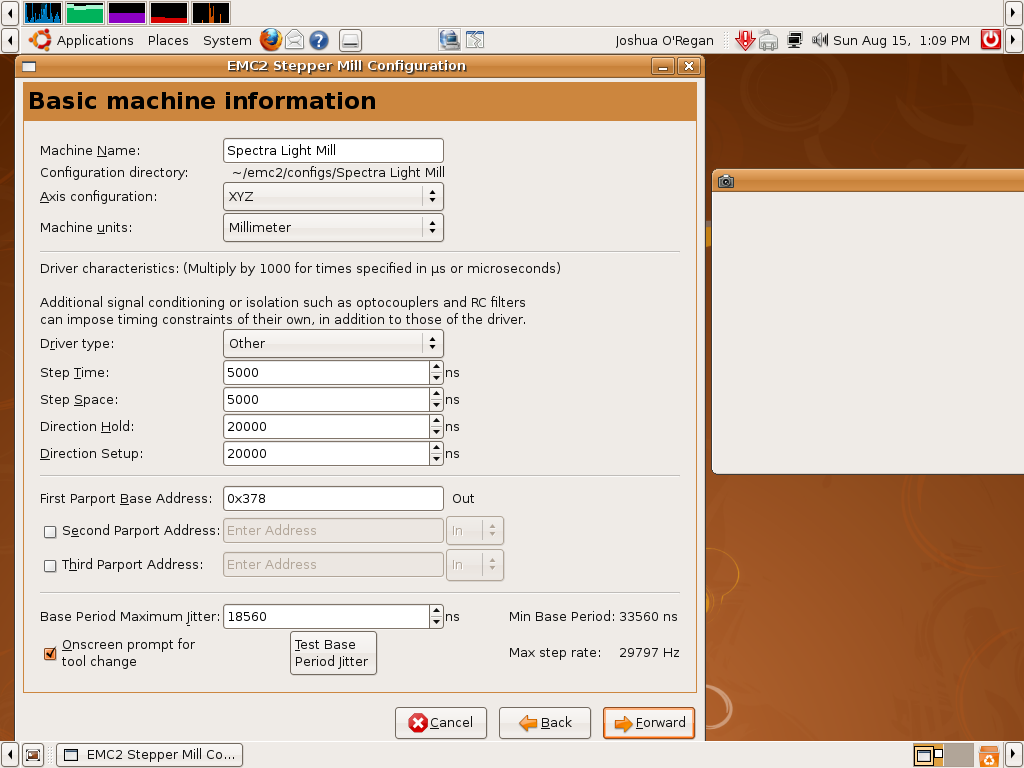

Ok I have now got it all set up to move as in your configuration, however the steppers make a lot of noises that sound like gears grinding in a manual gearbox and may move a little but will only move in one direction and will still make a whole heap of extra noise while moving...any ideas?

It sounds like you might be trying to drive the steppers too fast. Try making a drastic reduction in your velocity and adjusting your acceleration.

and or increase your step timing...

How much would I need to change the numbers by? Or would that be too machine specific to my machine?
