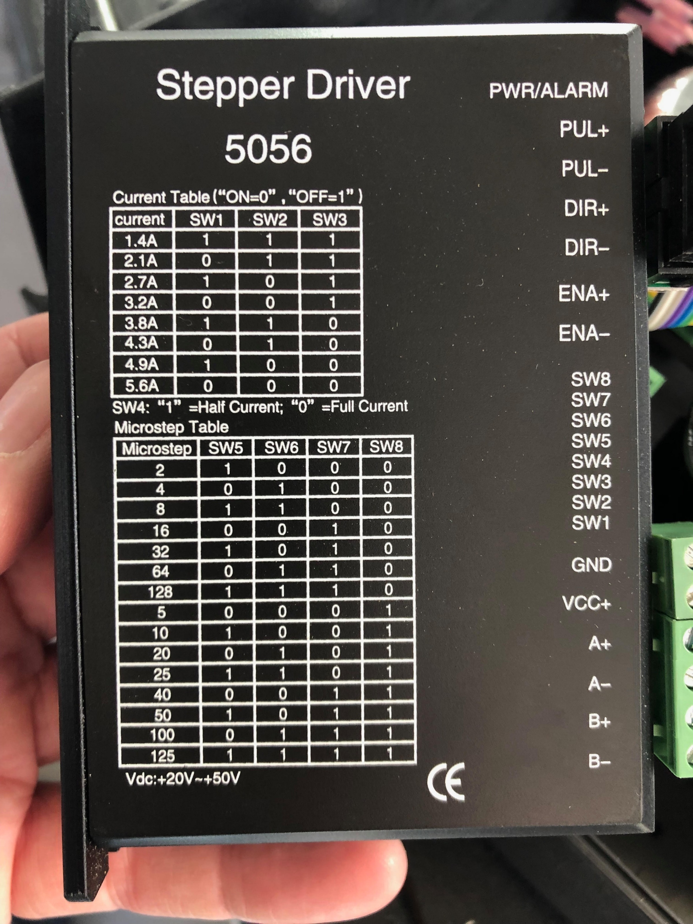

i am trying to find the driver timing settings for the attached stepper motor driver.. all i have for info on it is... the driver is out of a Probotix cnc controller. I have reached out to them but can not get a response... i am trying to get the settings in correct in the configuration. my current settings are
Driver Type - other
Step Time 1200
Step Space 1200
Direction Hold 5000
Direction Setup 5000
the closet thing i can find is MondoStep 4.2 Bi-polar stepper Driver.. however this is on the probotix web site and no information on the above settings
Driver Type - other
Step Time 1200
Step Space 1200
Direction Hold 5000

www.probotix.com/manuals/V90/emc2_step_conf.htm
This was in the help page. Most of the other stuff link back to this linuxcnc org

I believe that is the same drive a s a KL-5056.
www.kelinginc.net/KL-5056D.pdf
According to that manual the minimum timings are:
Step Time 2500
Step Space 2500
Direction Hold 5000
Direction Setup 5000.
And I would increase them at least 50% just to be safe. Unless it interferes with the maximum speeds you need, then set them as large as you can and still achieve your goals.
Step Time 2500
Step Space 2500
Direction Hold 5000
