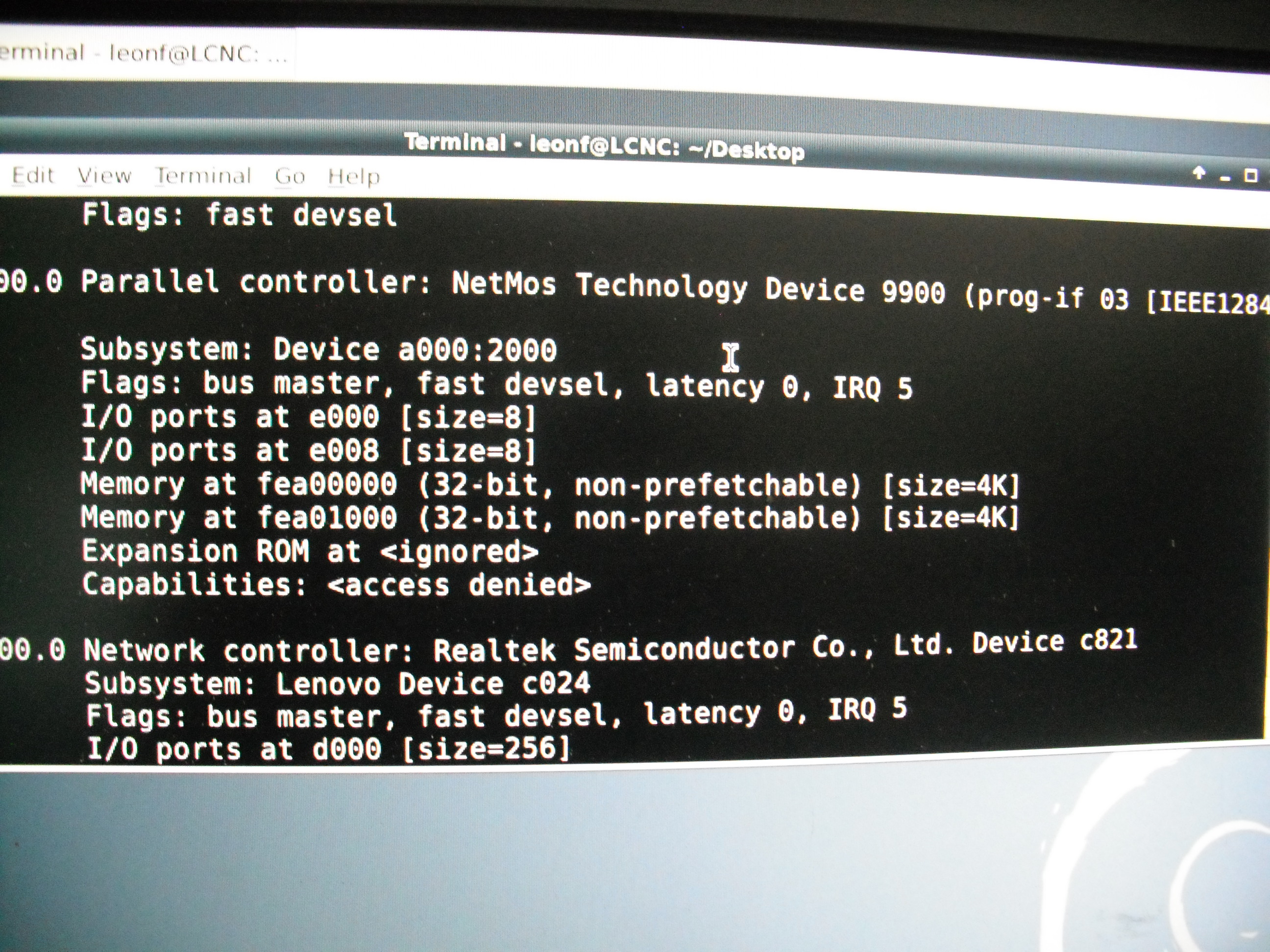

I'm using Linuxcnc-2.7-Wheezy
I ran, lspci -v, and got this message after installing my parallel port card in an open pcie slot on my motherboard:
I've tried using the values: "0xe000" and "0xe008" in my stepconf, but haven't got my motors to turn, yet. Could also be the pin assignment, but I'm fairly certain I've got my motor pins assigned to my breakout board correctly.

have you tried only zero?
i am not using pci card but i couldnt test the axis at first i got an error. i had to use port 378
there are some cards with certain chip sets that dont work

you shoudt do a
dmesg | grep parp*
in a terminal and post the output
it will tell you more of the card
dmesg | grep parp*

- LeonF

Here is the dmesg | grep parp*
I've also gotten a similar dmesg | grep parp* that doesn't include the Error message on the last line.
Here is where I am:
the 0xe000 address worked;
my "amplifer enable" pin assignment seemed was likely the problem - I have corrected this;
however I have intermittent success reproducing my results, with a new machine name field entry, when I test axes in the step conf wizard;
Sorry for the late reply, but I've been baffled and I didn't want to waste all of your time without being more critical of my set-up. Thank you all so much for your help.

Earlier on (before my initial post) I had originally bought a parallel port card that did have an incorrect chipset. However, I believe I remedied this when I installed a PCIe parallel port card with a SD-PEX10005 chipset.

01 Mar 2019 12:44 #127403
Replied by andypugh on topic parallel port driver issues, I think
can you try again without the grep, send it to a file and attach that file?
dmesg > dmesg.txt
