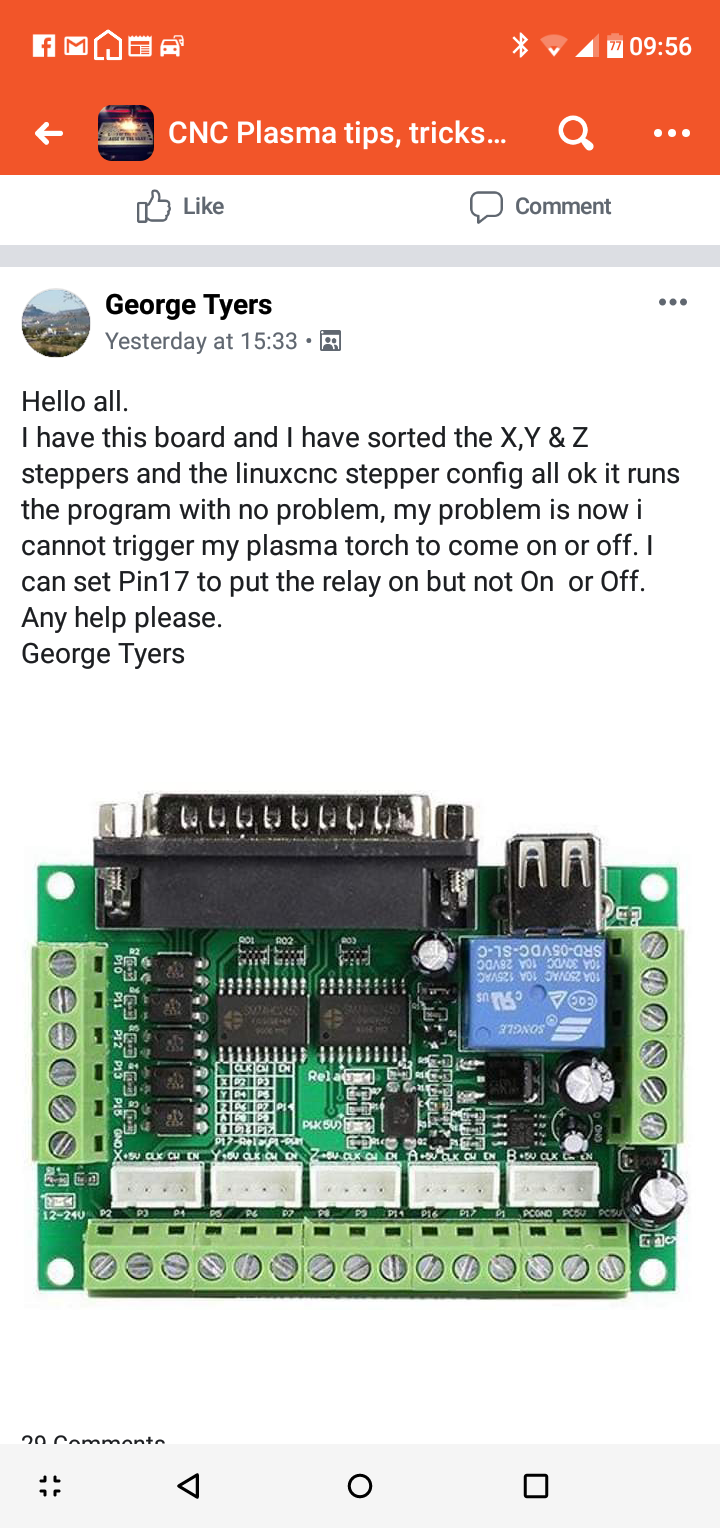

31 May 2019 08:01 #135450
by getyers
Plasma torch was created by getyers

- getyers
- Posts: 19
31 May 2019 15:28 #135478
by getyers
Replied by getyers on topic Plasma torch
i have set the parallel port to pin 17 spindle on, is it possible to draw a sketch for me as i am very very new to this.
george
george

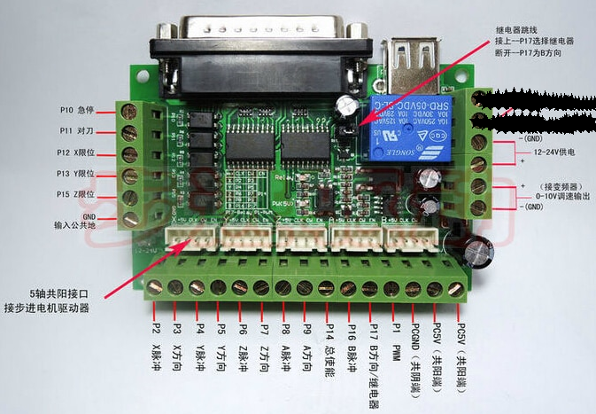

- Grotius
- Posts: 2419
- Thank you received: 2349
26 Jun 2019 00:40 - 26 Jun 2019 01:04 #137842
by Grotius
Replied by Grotius on topic Plasma torch
Hi Best board Ever Yes, best board ever !!
Maybe, not connect pin 17 of the board.
You need the relais output on the side of the board... Near the 12-24v supply output's.
See sketch :
I have a mach 3 Bob and I want to trigger the relay to switch On and Off. How to configure stepper config
This is not the problem, just use the step config wizard.
To explain a little bit more :
Pin 17 give's only 0v (off) or 5v (on). It makes no closed contact for starting a plasma torch, like a relais.
Therefor, jou need the relais output on the side. This blue relais is in the board circuit also connected to pin 17.
I think you heared the relais clicking already. So it has worked already.
See sketch :
