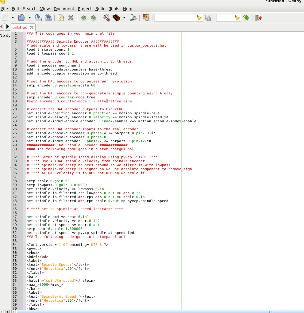

- Dinuka_Shehan
- Posts: 333
- Thank you received: 26
15 Jul 2019 13:16 #139489
by Dinuka_Shehan
Replied by Dinuka_Shehan on topic Update ini and hal file
These are the codes

- Grotius
- Posts: 2419
- Thank you received: 2349
15 Jul 2019 13:30 #139491
by Grotius
Replied by Grotius on topic Update ini and hal file
Geany is the easyest text editor for your example.
To intall geany type in terminal : apt-get install geany
If this giving nothing type in terminal : sudo apt-get install geany
Then at menu -> document -> set-filetype -> scripting languages -> python source file
Your text is displayed as :
Add your lines to your needs...
# = sign's are comments. (red color)
setp = set parameter
addf = add function
loadrt = loadrealtime
net = make a connection
=> or in your file <=> is only for fun, you can delete this if you want
If you are using parport, my advise is to use stepconfi wizard. Then you will see how to invert signal's by in-not.
I see you have a pyvcp screen designed, that is nice !
Good luck in editing !

- geewhiz
- Posts: 1
21 Feb 2021 15:27 - 21 Feb 2021 15:29 #199652
by geewhiz
Replied by geewhiz on topic Update ini and hal file
Grotius
re: Geany
"Then at menu -> document -> set-filetype -> scripting languages -> python source file"
I have been looking all over for this information!!!
I think this will solve one of the many ERRORS I am getting! Like this one.
"joypad_jog_speed.hal:11: Warning: File contains DOS-style line endings."
Do I have to tick "python source file" every time? or is this a default now?
Can I open the files I have already edited and make this change, then re save to fix them?
Thank you, I am very new, and struggling with Linuxcnc.

- Posts: 22027
- Thank you received: 7502
21 Feb 2021 16:30 #199659
Replied by tommylight on topic Update ini and hal file
It usually (or always) means the file was edited on a windows PC."joypad_jog_speed.hal:11: Warning: File contains DOS-style line endings."

menu -> Edit -> Preferences -> Files -> Default end of line characters
