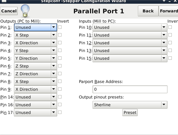

This is the line telling you what the problem is:
sim_hardware.hal:36: Signal 'fake-xstep' can not add OUT pin 'parport.0.pin-08-out-fake', it already has OUT pin 'parport.0.pin-02-out-fake'
Try commenting out these two lines in your .hal file.
fake-xstep & fake-xdir are already connected to out pins. I don't know what they are being assigned again.

OK the issue seems to be here:
file sim_hardware.hal line 36
Which seems to be here: look at lines 36 & 37
Should these have been lines 36 & 37.
Maybe a mistake whilst running stepconf ?
Debug file information:
6717file sim_hardware.hal line 36
net fake-xstep => parport.0.pin-08-out-fake
net fake-xdir => parport.0.pin-09-out-fakeShould these have been lines 36 & 37.
net fake-astep => parport.0.pin-08-out-fake
net fake-adir => parport.0.pin-09-out-fakeMaybe a mistake whilst running stepconf ?

You got it BeagleBrainz,, I just noticed the a axis later in the hal.

If I read your comments correctly the problem is that I want to program in dual axis on X. That was the plan from the start as i need to work out dual axis and homing. While my old cnc router uses dual X axis, X ans A joints have been fed the X step and direction feeds with homing just on the x axis. As they are fed the same step and direction homing never was an issue. With the new machine I am building I will be using rack and pinion drive. Rack and pinion drives are a lot easier to move when not powered up. Hence the need for dual homing.

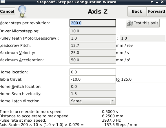

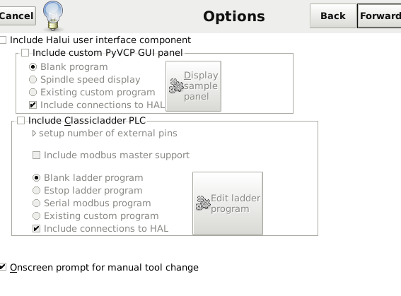

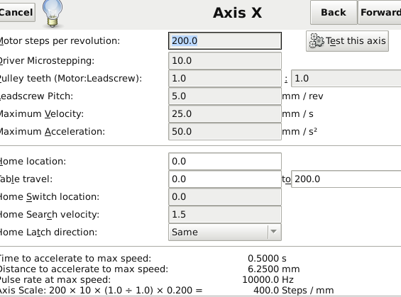

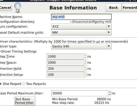

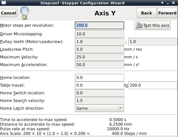

This brings us back to step config. I made this a very simple config file to keep things simple. Attached are the screenshots of how I went through them.
