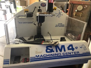

My isolation project is a craigslist special CNC with a D&M4 mill (based on the Sherline mill) that was previously started with a sound logic board for parallel control in place of the computer. I have the Mach xml file (attached but want to try Linuxcnc first.
Components:
* D&M4 mill with NEMA23 stepper motors.
* Sound Logic PC-2-Route rev 1.9
* D&M Chopper Drive
* Dell Optiplex 780
* LinuxCNC 2.7

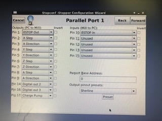

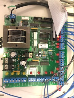

The pin out for step and direction is different that PC-2-Route rev 1.9 manual but with that solved x,y,and z run!
I am not able to decode the pinout for limits/home and would like some help setting up homing on the Z axis.
* The limit works with switch or jumper and LED20/Zlim illuminates.
* Recommended parallel port config for pin and name? (zHome on pin13?)
* I would like to visualize when the limit is touched in hal or a custom panel. (jumper to home/limit drives indicator in linuxcnc)

Open Linuxcnc, on the "machine" menu there is "show hal configuration", that opens another window, in that window on the right side click on the + to the left of "pins", find "parport" then "0". Now on the right upper side click on "show", and on the left choose the pins 10,11,12,13,15. Now on the right side you have LED that will go green or red depending on the state of that input, so trigger the switches by hand and check to see what switch is connected to what input.

Thank you Tommy for the quick reply. Pins10-13 are reading true/yellow are are unaffected by hand triggered limit switches.
The direction pins can be set by jogging an axis and Hal/the board LED agree.
*Edit The Bios is "PS2" with the option of AT/PS/2/EPP/ECP no DMA/ECP DMA1/ECP DMC3. Tomorrow I will attempt to use a resistor to discover if I have open collector pins and then check the cable. Thanks in advance.

Set the port to EPP mode, check again.
If they do not work, you might want to check the wiring first.
Is it a built in parallel port or an add on ?
Built in's work always, well except for one time that it did not, it required voltage to be supplied to the inputs as they did not have pull up resistors built in.
In any case, you can easily test that by using the Linuxcnc port tester and wiring pin 2 to pin 10 on the port, when you press the button on the tester it should change the state of the input also.

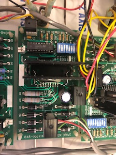

The internet went down at the street so I was unable to update. The resistor test worked so I have a PCI parallel port on order to provide additional data points..I will update when I am able.

The Z axis is up with homing in the new configuration below.
Components:
* SainSmart 5 Axis
* Stepper Motor Driver TB6600
* Dell Optiplex 780
* LinuxCNC 2.7
Two more drivers are on order so we can go ahead and finish this thread. The Sound Logic obviously works in Mach3 and may have an equivalent LinuxCNC but in jumping pins, the choppers gave up. Thanks for the support. If you need this particular board or can repair D&M choppers please let me know.
