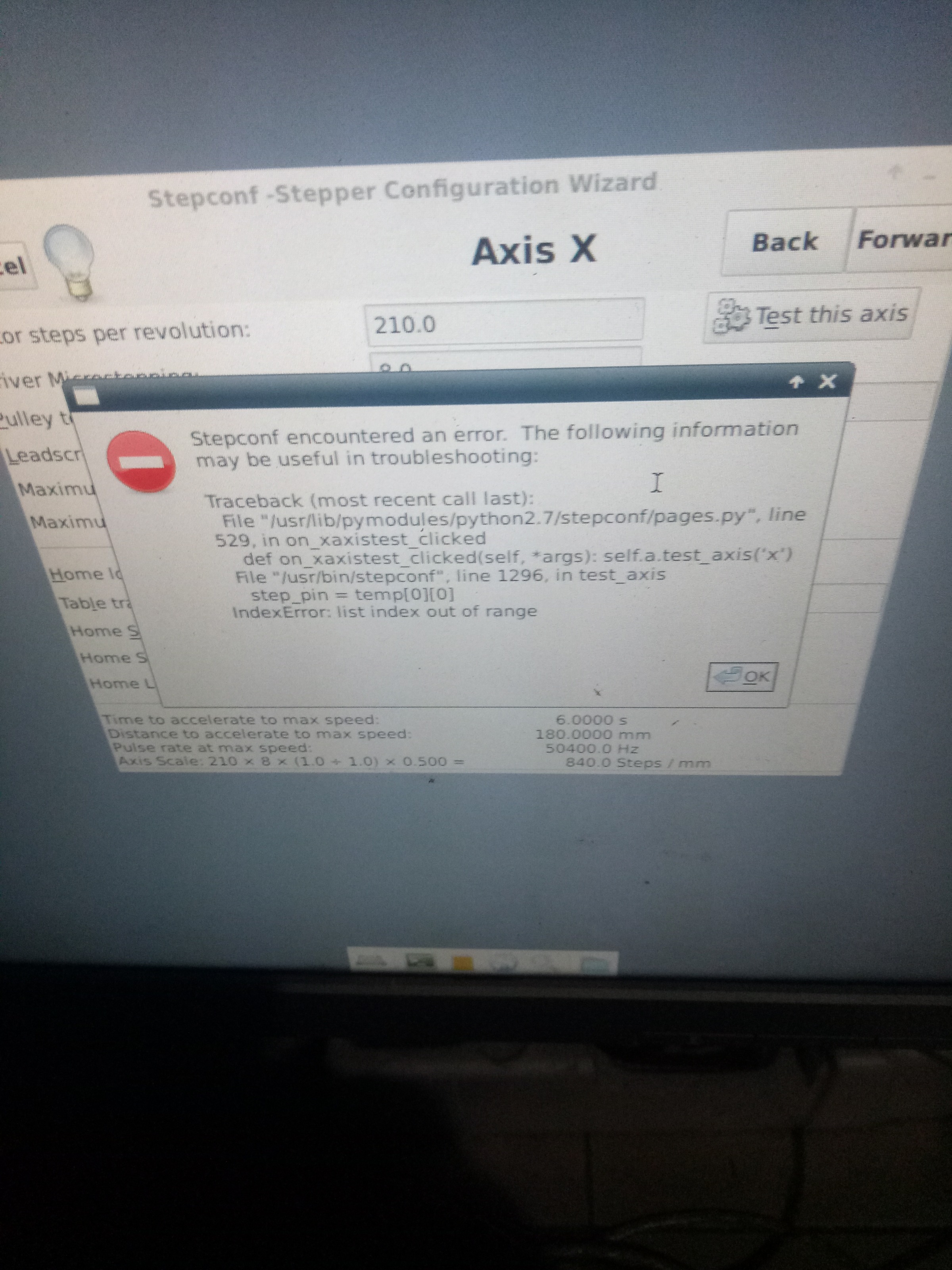

09 Jun 2020 03:33 #170750
by Trihwangyudi1990
Replied by Trihwangyudi1990 on topic Stepper problem
I have similar problem, but only my x axis can't move other axis is work well
I try to change my driver from tb6600 with tb6560 but its not work

09 Jun 2020 06:35 #170759
by bbsr_5a
Replied by bbsr_5a on topic Stepper problem
i use lots of tb6600 no problem at all
you need to set the microstepping to 1/4 or 800steps on this drivers
this reduces noice to almost nothing
the max speed depends on PC but under 100k standard base latency from stepconf
you get
the ACC not over 500mm/s²/s²
while the VEL depends on scale at 100 =0,01mm per step its for me 200mm/sec
you get
dirhold 35000
dirsetup 35000the ACC not over 500mm/s²/s²

11 Jun 2020 00:42 #171025
by Trihwangyudi1990
Its work smoothly..thanks
