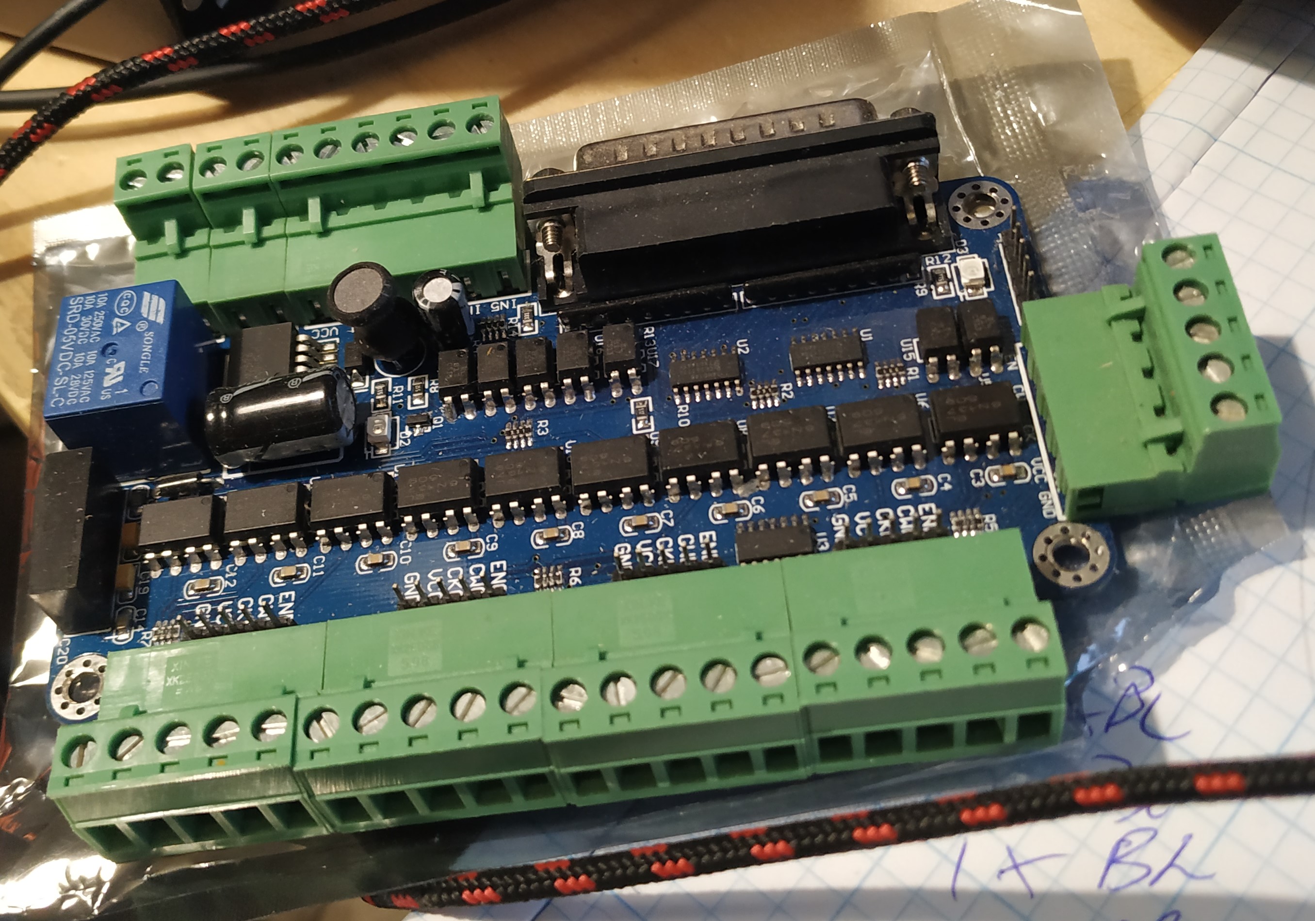

I have this other BoB 5 axis board also screenshots of stepconf for it please? was created by gzcwnk

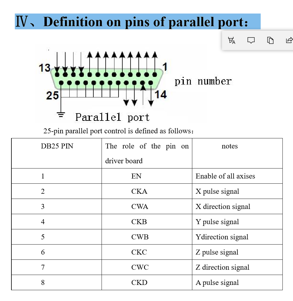

1 is the enable all, this would be EM stop out? would it be inverted?

Hi
Welcome
FOR the First setup you shoudt leave the ENA+ and ENA- of your Drive for testing unconnected
then as the machine moves in real AXIS/Gmoccapy
open up the config again and connect the ENA+ ENA-
then on F1 Keybord hit or Machine ON Button you see if it goes on or off
Best practice
What Drives are you using on this board
Welcome
Best practice

Replied by tommylight on topic I have this other BoB 5 axis board also screenshots of stepconf for it please?
It should be "machine.is.enabled" not e-stop, and yes it can be inverted in hal.1 is the enable all, this would be EM stop out? would it be inverted?
