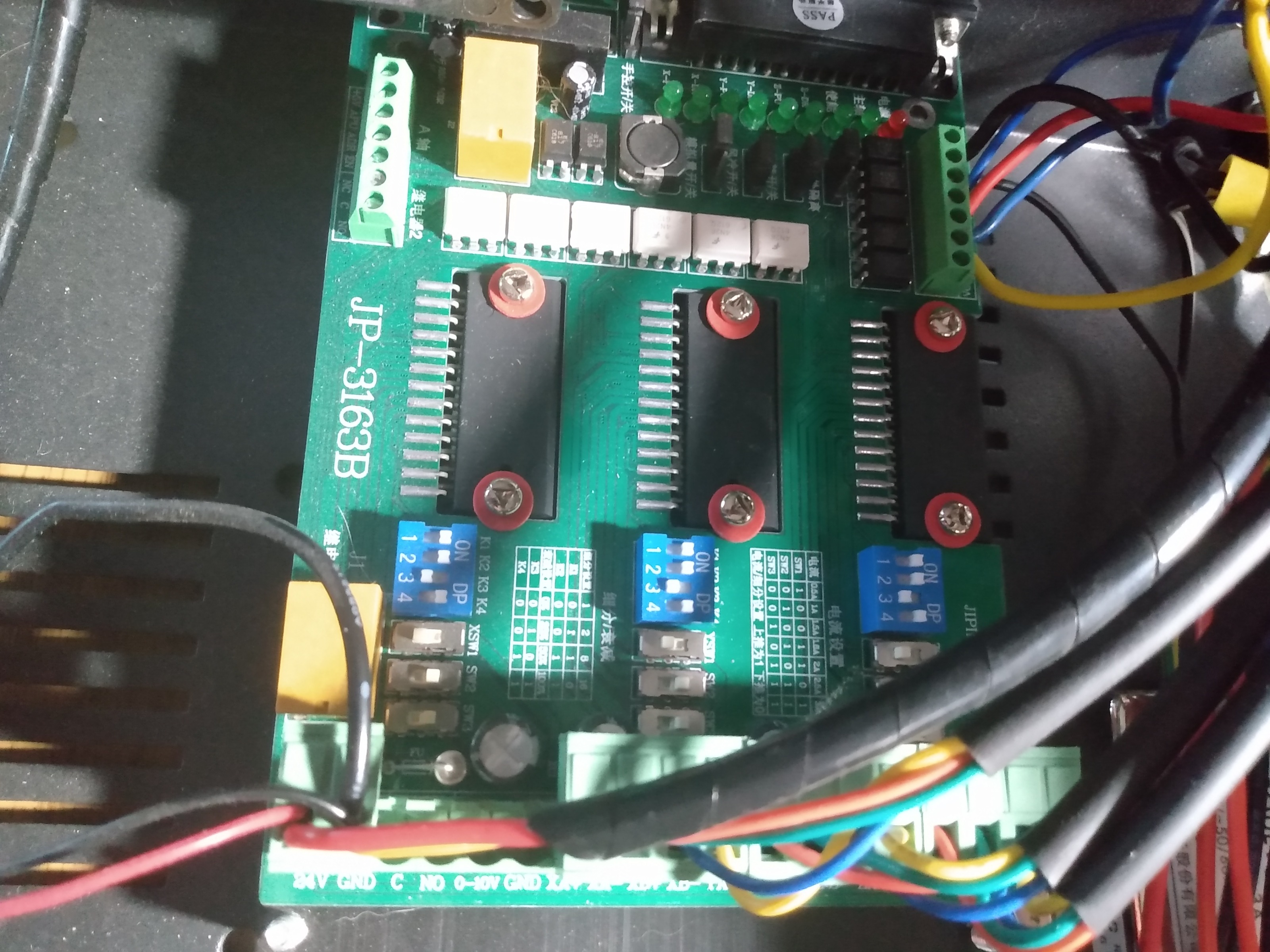

OK, when you say "on both the drives" do you mean the dip switches on the control board?

Do you have one of those TB6560 drive thingies with 3 or 4 drives on it?
Replied by tommylight on topic Newbie, configuring 6040z issues
What control board?OK, when you say "on both the drives" do you mean the dip switches on the control board?
Regards

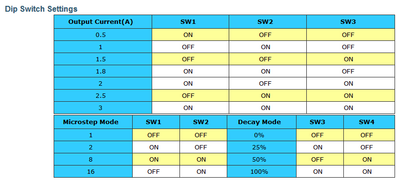

This is a JP-3163B control board. Factory Chinese 6040z. I also found a site giving the DIP microstepping positions but none of them correspond to what I see in my machine. Now this machine is a "new to me" from a frustrated first owner so who knows, he may have changed something and not remembered to tell me, etc. The image of the control board is from my machine.
