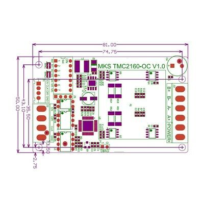

MAKERBASE MKS TMC2160 and MESA 7I96e was created by stefan63

Not sure what to do with ENA either connect to 7I96 +5V or leave open...
Is there a manual on the MKS2160?
Replied by PCW on topic MAKERBASE MKS TMC2160 and MESA 7I96e
7I96 TMC2160
STEP+ CLK
DIR+ DIR
GND GNDNot sure what to do with ENA either connect to 7I96 +5V or leave open...

Ok that is the way I have connected it (ENA is not needed as it is enabled when inaktive) but I still have no motion. must be something in my hal config then...

Replied by andypugh on topic MAKERBASE MKS TMC2160 and MESA 7I96e
Are the motors locked? If they are, then the drive is active and working.
If they are not, then I would look at enable more carefully.
What step length did you choose?

Got it working with default settings for 7i76e (Sorry for the error i made with type number) by installing latest LinuxCNC ISO
