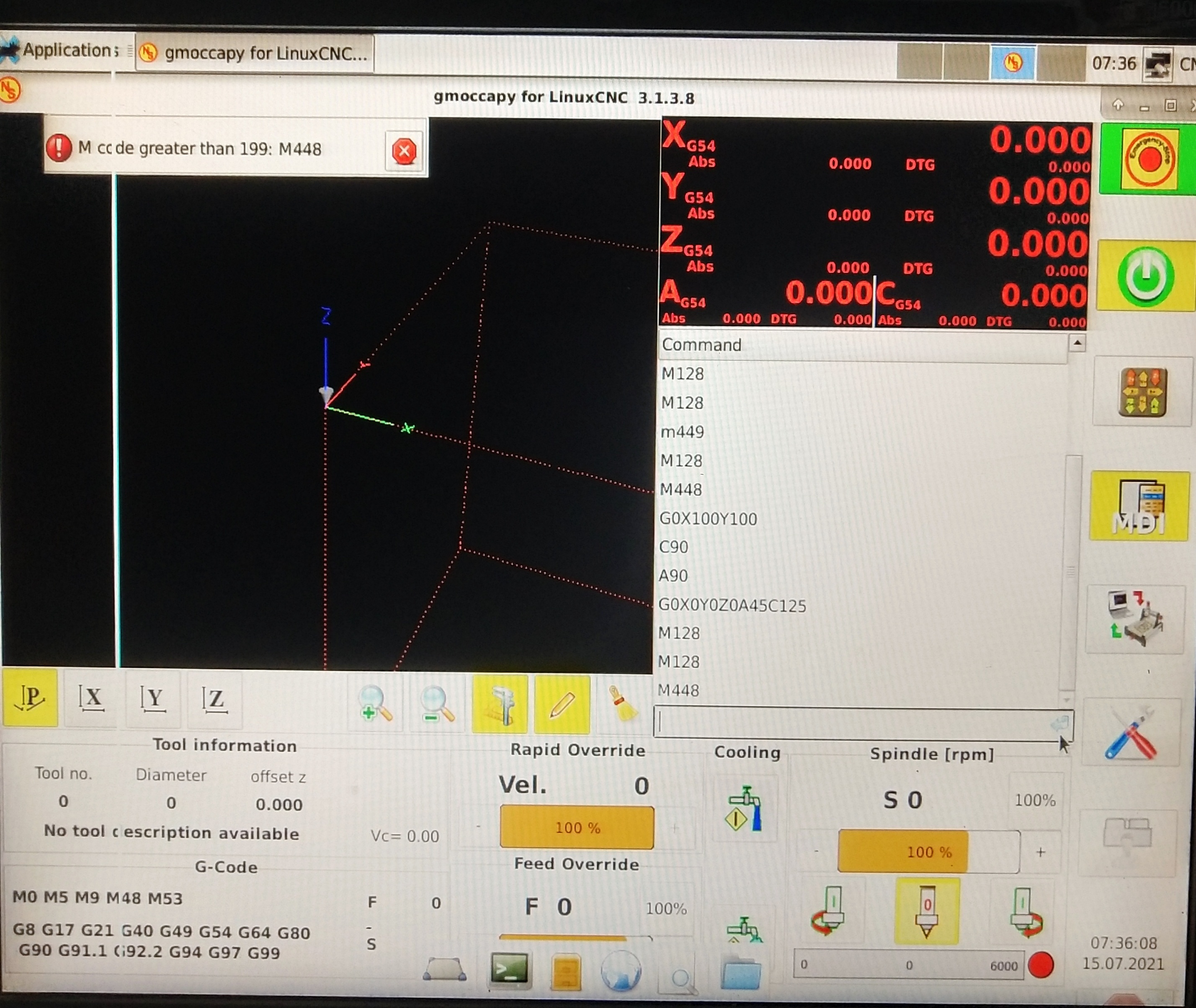

15 Jul 2021 11:38 #214848 by REX299
Replied by REX299 on topic Need help to install 5 axis knematics
Yes i ran but knematics is not woking (u can see attached file) .
15 Jul 2021 11:57 #214851 by Aciera
Replied by Aciera on topic Need help to install 5 axis knematics
Yes that is correct because you are lacking the remaps in your config folder.
1) In your machine config folder create a folder named
remap_subs
2) Navigate to
/home/user/linuxcnc/configs/sim/axis/vismach/5axis/table-rotary-tilting/remap_subs
and copy the two files named '428remap.ngc' and '429remap.ngc' to the folder you created in step 1
3) in your machine config folder open the ini file and add this to the [RS274NGC] -section
SUBROUTINE_PATH = ./remap_subs
HAL_PIN_VARS = 1
REMAP = M428 modalgroup=10 ngc=428remap
REMAP = M429 modalgroup=10 ngc=429remap
