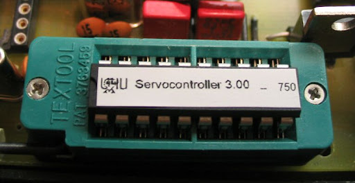

Hello guys!
Anyone knows the timming settings step/dir for the UHU servocontroller from uhu-servo.de/ ?
Thanks !
Thanks !

Replied by tommylight on topic UHU Servocontroller
Start with 5000 for step time and space, leave dir setup at 20000.
Later you can try lowering just the step stuff, leave dir at 20000 as it does not lower the overall speed, but can cause missed steps if to low.
