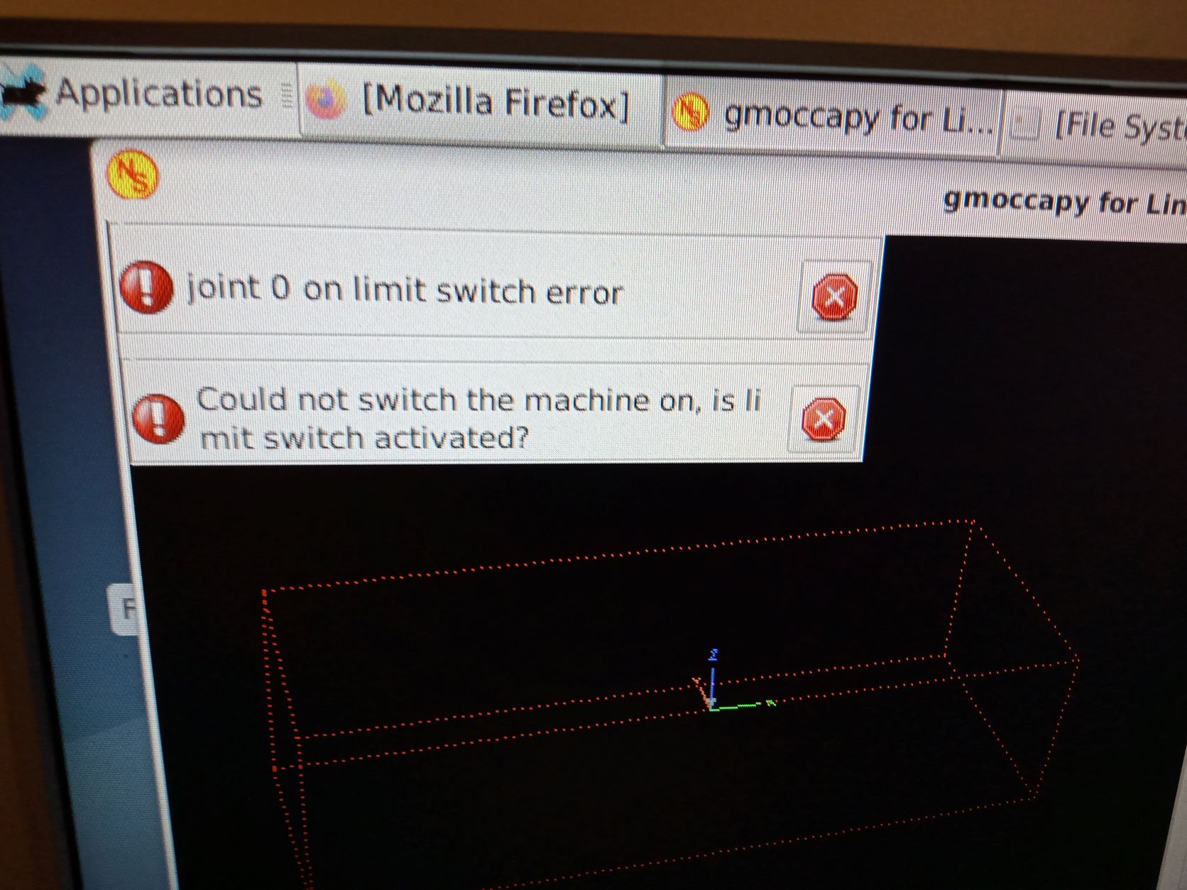

13 Nov 2021 17:24 - 13 Nov 2021 17:31 #226332
by PhilipME
error setting limit switches was created by PhilipME
Last edit: 13 Nov 2021 17:31 by PhilipME.

13 Nov 2021 17:44 #226335
by PhilipME
Replied by PhilipME on topic error setting limit switches (SOLVED)
Apology
I found the power supply to the out put pins was off
very stupid
very stupid

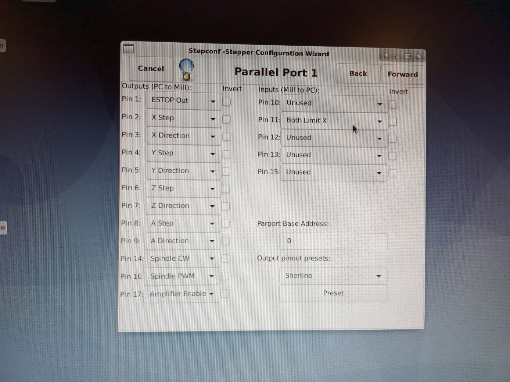

13 Nov 2021 17:44 #226336
Replied by tommylight on topic error setting limit switches
Check the invert box on the right side of the pin/pin name.
The following user(s) said Thank You: PhilipME

13 Nov 2021 17:56 #226338
by PhilipME
very cool
when the machine reach the limit and trip, I hear music
