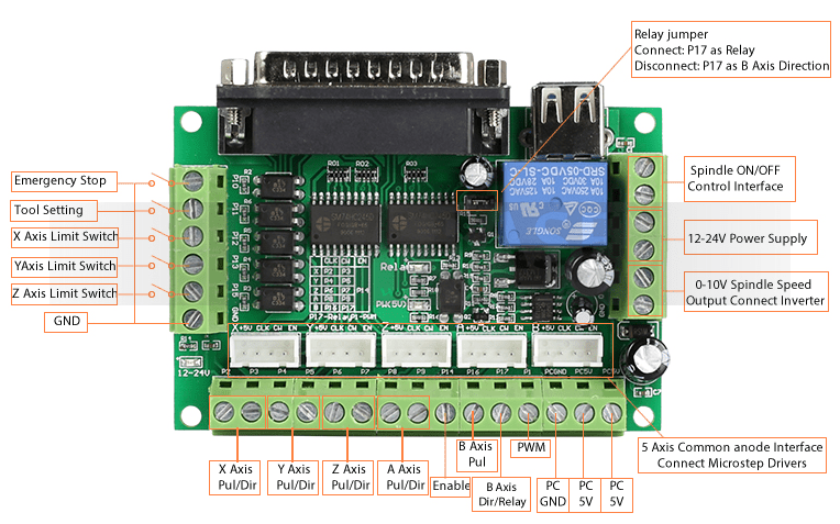

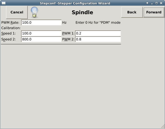

The actual spindle speed does not mach the m3sxx command in the MDI terminal
Where do I get the pwm rate from?
I have the bob in the picture (If it is needed for determining the pwm rate entry in the stepconf spindle page ! )
question 2 for calibration:
do I need to measure the 0-10 volt and if it is for example 1 volt, then for calibration I enter pwm signal as 0.1 and take the reading from the spindle vfd of the speed say 40 herts = 2400 rpm
and the second point for example 9.8 volt means pwm(The maximum the bob gives) = 1 and the rpm is 24000 rpm for the second point.
Is my understanding correct?

Replied by andypugh on topic Where do I get the pwm rate from?
You shouldn't need to measure anything to calibrate it. 100% pwm should run the VFD at the programmed max speed.
So, set the pwmgen scale to the max speed, and connect it to the correct rpm HAL pin and the motor speed should match the commanded speed,
Note that the BoB will not generate 0-10V without 12 to 24V on the 12-24V power supply pins.
