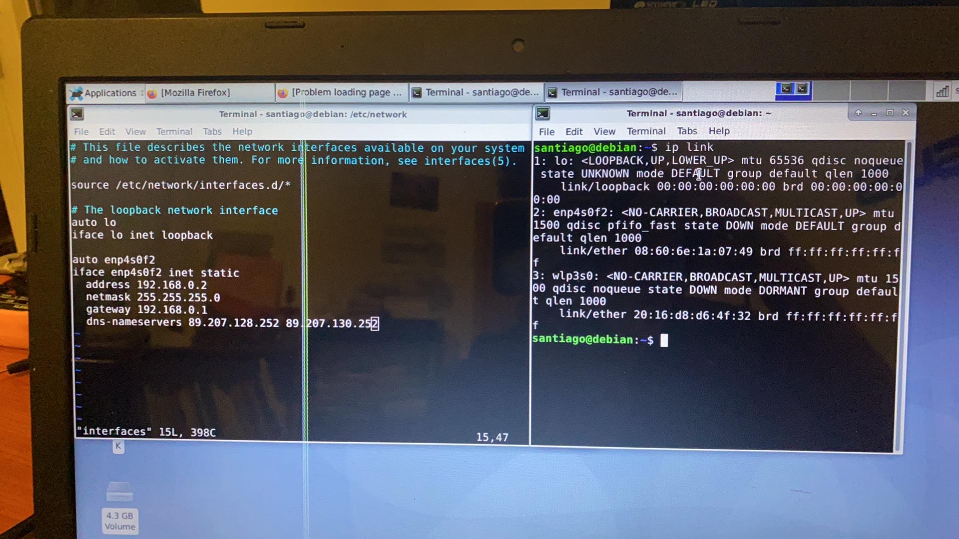

Hello.
i have been trying to connect to 7i96s board via ethernet, but can't seem to configure ethernet properly anytime.
already tried what some guides tell me to do with 10.10.10.10 and also with 192.168(....), but no connection established. anytime i try to open my config it gives me this error:

hm2_eth: ERROR: Could not retrieve hardware address (MAC) of 10.10.10.10: Resource temporarily unavailable

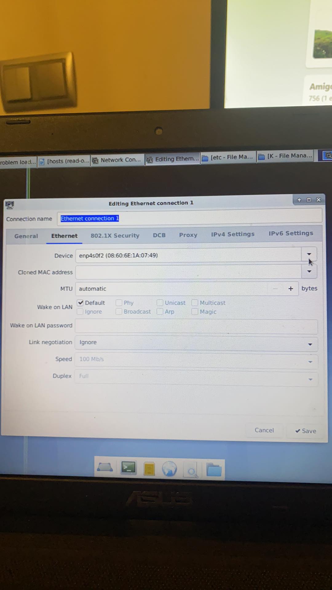

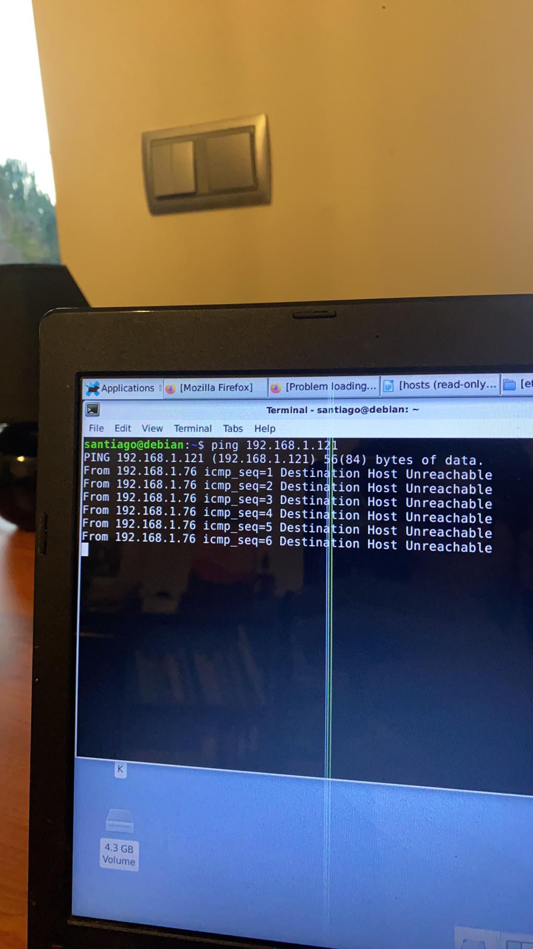

11 Oct 2022 18:49 #253977
by santy
Replied by santy on topic Newbie trying to connect to 7i96S for months without success.
Yes but with a new install ethernet is not yet configured with a static ip, so im having quite some trouble.
here are some pictures of some commands . im using eeprom connection so i thought a 10.10.10.10 ip would work.
- Posts: 18111
- Thank you received: 5330
11 Oct 2022 22:55 #253986
Replied by PCW on topic Newbie trying to connect to 7i96S for months without success.
It appears you have not set a static IP address
using the network manager GUI
tommylights post gives the instructions for this
