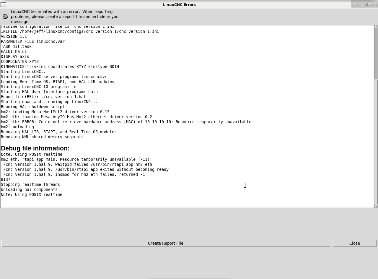

Error message was created by Jdog
- Posts: 22006
- Thank you received: 7490
26 Feb 2023 22:57 #265448
Replied by tommylight on topic Error message
Scroll a bit lower, the "debug" part?
- Posts: 19899
27 Feb 2023 00:34 #265460
Replied by andypugh on topic Error message
Or, better still, press the "create report file" button and attach it to a message here.
- Posts: 18115
- Thank you received: 5334
27 Feb 2023 02:35 #265469
Replied by PCW on topic Error message
The "Could not retrieve hardware address" error means LinuxCNC cannot communicate
with the Ethernet card.
What does the command:
ip a
report?
ip a
report?

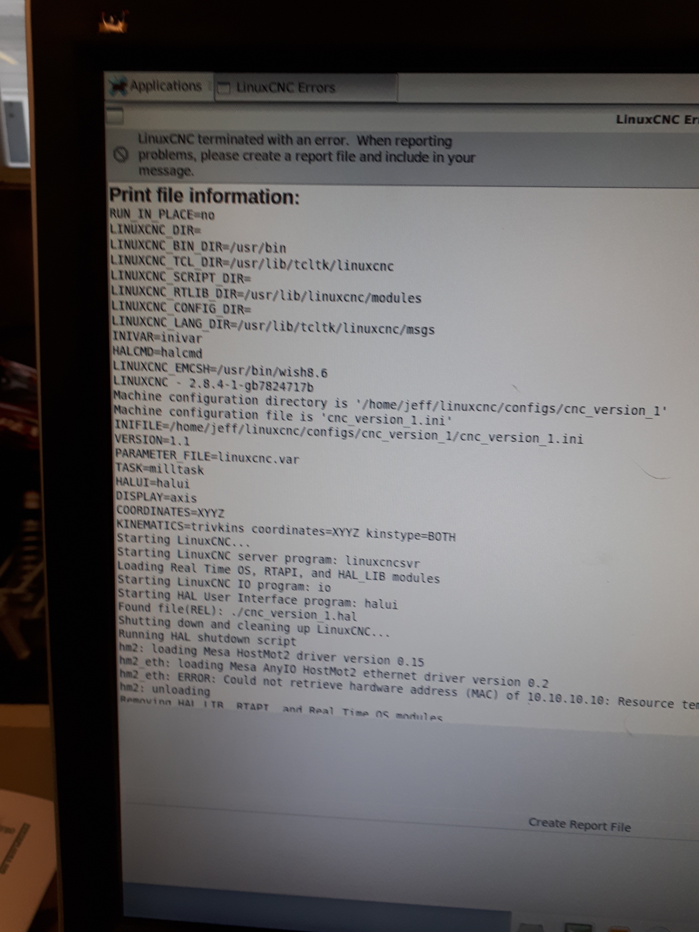

Hi Tommy i re-posted the whole message down below. I couldn't figure out how to attach it directly in a reply to you. Sorry I'm very green when it comes to this stuff.

I actually figured it out now. I had to switch the jumper pin on the mesa card to accept ip address (Not sure the correct terminology).. Everything loaded fine after that and i managed to get all motors functioning but will need to fine tune yet. Just in the process of setting up limit switches now. Getting closer each day. Thanks again everyone.
