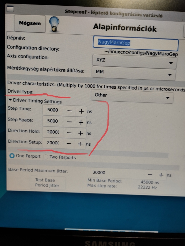

Hi everyone,
I'am newbie in the electronic questions.
I make the the config process, but i dont know CW8060 driver timing values.
The first two pics from the device dokumentation, third pic are from stepconfig.
Thanks for helping!
Steven

Replied by tommylight on topic CW8060 stepper driver timing settings
That is OK acording to spec sheet, but i would double the step time/space just to be sure, so 10000, or try as is and if you notice rough motion of motors or lost steps/stall, set it to 10000.
