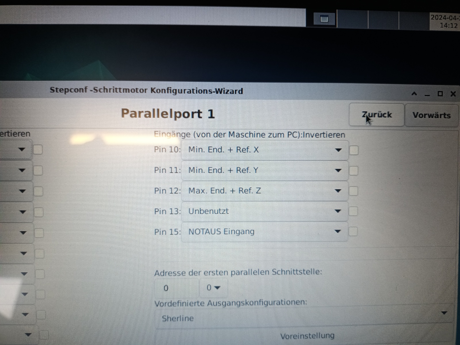

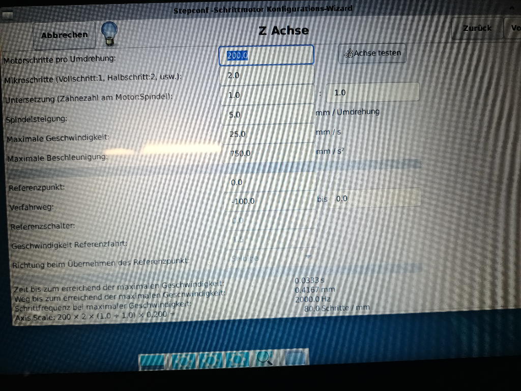

Hi everyone,I used to work with linuxcnc 2.7.1 for some time on my self build 3-Axis mill. All axis have Ref-switches and everything worked fine, referencing and working.I got a new PC and wanted to upgrade to the newest linuxcnc. Installation went perfectly smooth and the system is incedibly fast and such.Stepconf however doesn't let me configure a Ref-switch for my Z-axis. X and Y - no problem, I can configure them as on my old system and both axis reference without any problem. On the setup page for the Z-axis however is everything around the ref switch greyed out,
I attached 2 pictures. These configurations were standard from stepconf and even then the Z-axis is greyed out. Any Idea anyone?
Thanks,
Sebastian
Thanks,
Sebastian

Replied by tommylight on topic Z-Axis no Ref configurable
You have not assigned a pin for the Z axis switch in the pinout page.
- Satai
- Posts: 7
25 Apr 2024 13:42 #299067
by Satai
Replied by Satai on topic Z-Axis no Ref configurable
I assigned the pins as seen in the attachment, sorry, forgot to attach it
- Posts: 21861
- Thank you received: 7458
25 Apr 2024 13:48 #299068
OK then seems to be an issue with StepConf, probably language, but that is only a guess.
