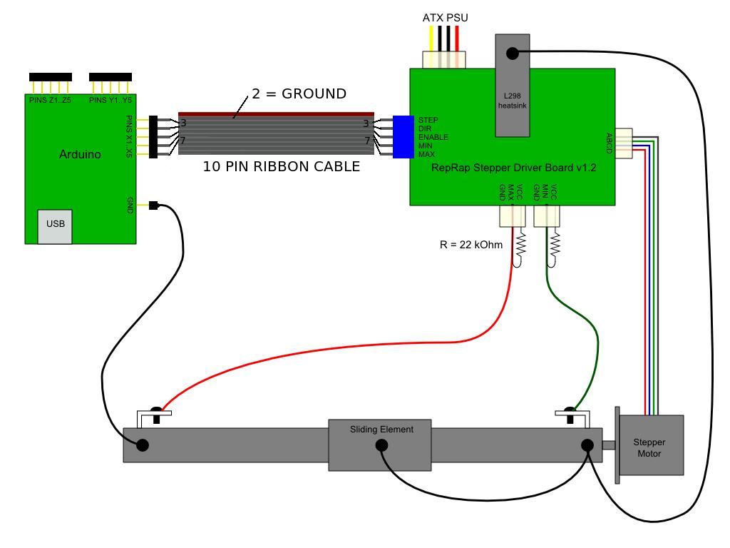

I'm using a RepRap Stepper Motor Driver 1.2 which is wired as you can see here www.flickr.com/photos/mantao05/437399371...es/o/in/photostream/ . It's an ordinary L297 / L298 board with STEP, DIR, ENABLE, MIN-LIMIT and MAX-LIMIT pins. For each axis one board is necessary. Where you can see the Arduino board in the drawing, I'm connecting a parallel printer cable, which is connected to my PC, without the ground contact. For further informations please have a look for Wiring . All axis are wired and configured identically.
Maybe I missed something, but I have not seen how you wire the parallel printer cable to the whole thing.
why without ground contact ?

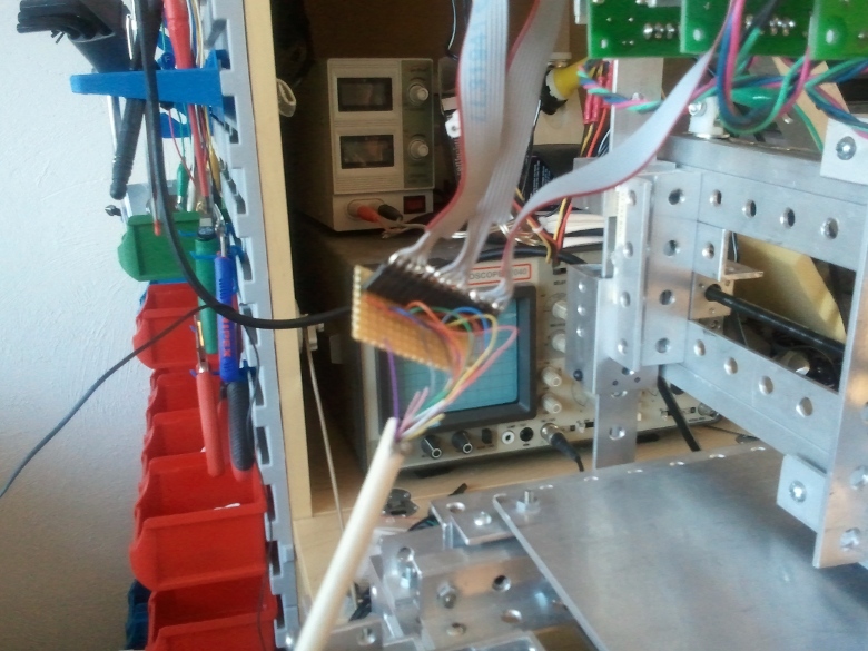

Here the description how I connected the stepper driver pins to the parallel cable. First I cut off one end of the parallel cable and connected the soldered the wires to a stripped perfboard. Via a pin connector I attached the stepper drivers. To reduce EMF i wrapped the whole thing with aluminum, of course isolated it before.

So to make the adapter from the parallel port to the L297 / L298 boards I made something more reliable and conntected the GNDs. to one parallel port GND.
I also connected the ENABLE signals parallel to the L297 / L298 ENABLE pins.
