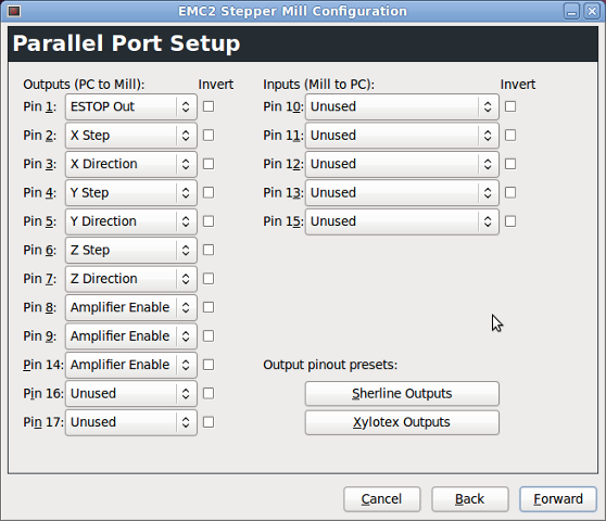

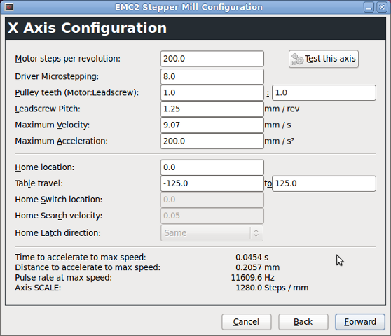

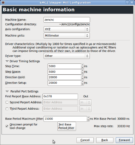

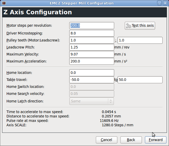

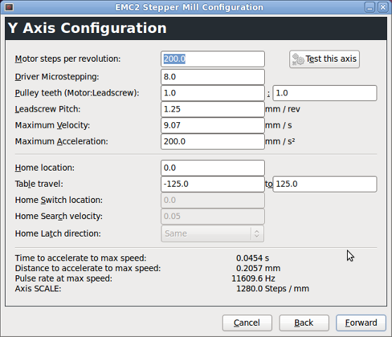

So I have a new setup that I was able to quickly get up and running and all was great(zentoolworks 7x7 kit). I didn't notice until I tried to run my first gcode that it was off my 1/5 on all axis. So I went back to the config wizard and tested there. Sure enough, 100mm only gave me 20mm of travel, 50mm = 10mm, etc. Most of the config was copied from their wiki. Here is the hardware:
nema 17 stepper motors 1.8deg
1.25mm pitch leadscrews
cncgeeker.com's 3 axis board TB6560 has 1, 1/2, 1/8, 1/16 microstep resolution (set for 1/8)
I just can't seem to get it to be the correct distance. I even tried setting to microsteps on the driver to 1 because that was the complete opposite setting for dip switches, figured I might be reading them upside or something.
Here are my configuration screens.
Help would be greatly appreciated I'm racking my brain trying to get this to work.
Antoni

If you are off by 1/5 try just changing the pulley setting to 1 to 5.
After using Stepconfig to create the proper setup I often just go into my configuration file and edit the scale to get the right movement.
Rick G
15 Mar 2011 13:07 #7851 by BigJohnT
Just like Rick I just change the scale number to be what I need. All the other numbers don't mean anything only the Axis SCALE: number is used. So it looks like yours needs to be 256 or there about. But that number does not sound right for 200 steps a rev at 1/8 microstepping and 1.25mm pitch for a direct connection.
You don't mention if your steppers are directly connected to your lead screw or via a reduction belt.
For testing I put a mark on my stepper shaft and make sure I know how many steps it takes to get one rev on the stepper... then go from there.
John

15 Mar 2011 14:45 - 17 Mar 2011 11:23 #7856 by BigJohnT
The scale won't have any effect on hardware communication, however if your using the parallel port there is a limit to how fast you can send out steps and this times the number of steps per user unit limits your speed. So in plain talk if you select 1/16 micro stepping on your driver you have to send 16 times the number of steps to move a given distance. No micro stepping is best for high speed and micro stepping is best for slow speed. You will have to find the balance that you want if your drive does not morph from micro stepping to single stepping as the speed increases like a Gecko 203v.
I just put a mark on the shaft or somewhere and if I expect a move of 1.25 to be one revolution I just issue a feed move of 1.25 at a slow feed rate and observe the shaft of the stepper and see if the mark makes one full revolution. I do this in Axis but I think you can do it in the "Test this Axis" of stepconf.
John

So the only way I could get the conf to make the correct amount of movement is with getting the axis scale to 6400steps/mm. I had to turn the vel and accel way down to .5m/s and 50 respectively. The movements are not smooth at all. It's vibrating/pulsating fairly well. There seems to be more error introduced as well. If I let it bounce back and forth around one revolution it seems to fluctuate between .003" and .010" I also bumped my jitter setting to 50k. When I had it set for 1280steps/mm the scale would be off but the movements were smooth and accurate. I'll have to compare with my uC tester because perhaps the error is being introduced by the hardware.
I understand that I can correct the steps/mm axis scale to fine tune everything. However it's still 5x off. That seems like a huge number to indicate that something is not right and it's obviously pc/setup related.

The Arduino is a nice solid 5V 25mA signal. Your parallel port might well not be.
First, can you measure the voltages on the parallel port when stepping? A scope would be best, but that Arduino has some nice anaolgue inputs.
How do you have the P-port wired to the drives? Generally a P-port can sink a lot more current than it can source. Many ports are only 3.3V. A 1k pull-up resistor to 5V (which you can source from a USB port) might help to firm up the signals.
This diagram here shows a typical scheme (except it is wired to some logic chips, rather than stepper drivers)
Do the drives have an opto-coupled input? If so then the way to wire is with +5V to the + side of the input, and the p-port to the - side, then current flows through the opto when the port pin goes low, activating the input.
17 Mar 2011 16:41 #7900 by cncbasher
i would check your Latencey timing , also try reversing the logic of the step and direction lines , i'm sure it's timing related etc , hope it's not a Laptop of course .
try slowing down the velocity and acceleration , it could well be a combination of one or both .
i would also reduce your microsteps to 1/2 or 1/4 to start with , easier to find the problem and then increase later , although i do not see any benefit running greater than 1/2 step , with your table setup , as your driving the shaft directly .
