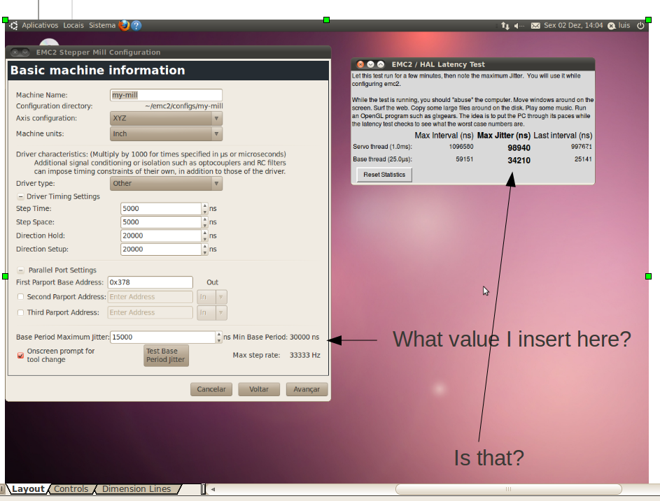

Hi all.
what value in latency test I insert in stepconfig base period Max jitter?
This are some values i found.
Max interval(ns) Max jitter(ns) last interval (ns)
Servo thread(1.0)ms 1004722 7461 997410
Base thread(25.0)us 33510 8569 25126

The max jitter or latency is the important number and anything < 10,000 is real good.
wiki.linuxcnc.org/cgi-bin/emcinfo.pl?Latency-Test

On your screen shot it would 34210
Take a look here..
linuxcnc.org/docs/html/config_stepconf.html#cha:Stepconf-Wizard
