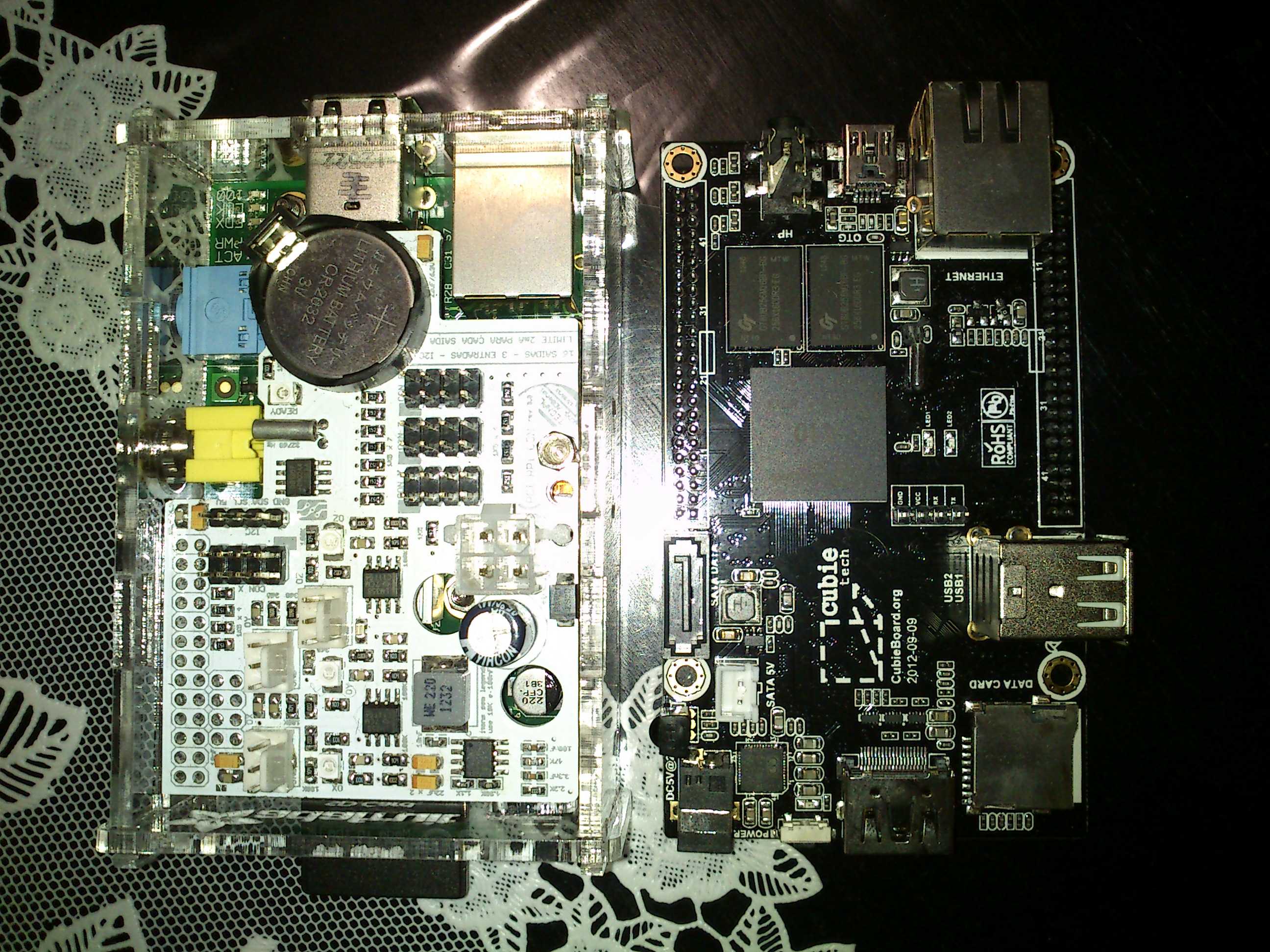

01 Dec 2013 21:02 #41285 by ADBensi
Replied by ADBensi on topic EMC2 running on Raspberry Pi?
Hello to all,
  I'm new to the forum, I'm downloading the RPI-lcnc.img image and plan to mount a PICnc Jr Board to participate with you.
  I have a Raspberry controlling 4 stepper motors using ethernet (Delphi program and drivers direct on Raspberry), and has since I turned into an enthusiastic with CNCs.
  When I understand how this work works I would port it to Cubieboard (DDR3 1GB, 1GHz, 4GB).
This would motivate me to learn about Realtime Kernel and would be mode to exchange experiences with the group.
Best Regards
02 Dec 2013 00:59 #41286 by andypugh
Replied by andypugh on topic EMC2 running on Raspberry Pi?
Just by way of a warning, when I tried using the RPi step generator of real hardware I found that the pulse train wasn't very regular, and it didn't work very well.
I think that more development is needed.
LinuxCNC is known to work well on the Beagle Bone Black, and I am hoping to see if I can get it working on the Udoo board (which is an ARM PC, with an on-board Arduino.

02 Dec 2013 02:44 #41288 by ADBensi
Thanks for the tips and for the warning,
  I've had experiences where the performance of Raspberry was not enough, then I migrated to Cubieboard and works well. Knowing their recommendations I will be more cautious and more confident in porting to Cubieboard.
   KL25Z-FRDM is interesting, especially because it simplifies Jr Board PICnc for driver only. Now, ever wondered about using drivers with SPI interface like A3981, L6470?
  I am running LinuxCNC from an ssh-X. I'm wondering how to configure the Hal to use SPI. What would be correct to raise linuxCNC with RPI + Jr Board PICnc por exemplo?
Best Regards
02 Dec 2013 06:10 #41289 by kinsa
Replied by kinsa on topic EMC2 running on Raspberry Pi?
Best Regards
The A3981 would need a dedicated SPI channel per axis; implementing a driver would be a bit complicated.
If you want to port to Cubieboard then you'll need to modify src/hal/drivers/hal_spi.c (from unified-build-candidate-3). I'll be updating this driver to handle both PIC32 and KL25Z-FRDM boards.
