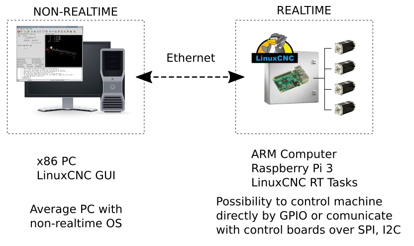

I figured out how to solve a GUI problem on Raspberry Pi without consuming a lot of programming time.
What if the GUI was on the x86 computer and the other realtime tasks would run on RasPi?
These two computers could be connected by Ethernet, I know that RasPi has a USB-based ethernet but for non-realtime data it might be enough.
Would it be difficult to do something like that?
One of the benefits could be that the PC with the GUI could be a Windows machine on which could also be CAD / CAM software. GUI on windows machines could help to popularize Linuxcnc, I know many people who are still using Mach3 because they are afraid of Linux OS.

11 May 2017 04:21 #93011 by DaBit
Replied by DaBit on topic EMC2 running on Raspberry Pi?
If you intend to go that route I would suggest to give the MachineKit project a closer look.
Their MachineTalk or whatever infrastructure is suited for this and they do have Qt5 UI's running on Android/Windows.
And if you go that route you are also better off using the BeagleBone (better latency figures, two helper processors named PRU for stepgen/encoders/pwm) or even better the DE0-Nano-SOC board (which runs the Mesa FPGA code allowing connection of all things Mesa).
Another option is remote X. OpenGL can be tunneled over the pipe also, so rendering happens locally at the X server running on PC. Check out MobaXTerm if you need an integrated SSH/X-server/Cygwin environment on Windows.
Huge disadvantage of remote X is that the application terminates when the link fails.

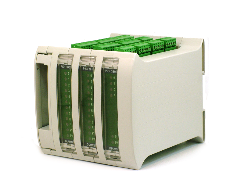

12 May 2017 04:15 - 12 May 2017 04:19 #93064 by viktan
Replied by viktan on topic EMC2 running on Raspberry Pi?
I will look at the machinekit, maybe it's a way to solve this problem. Another way could be to use CODESYS, they have support for Raspberry Pi and there is also cnc functions. It could be much more easier to build GUI over standard HMI software than code it in Qt5.
The initial idea was to build a controller that will have compact dimensions, the data will be mounted on a DIN rail and will not need a standard PC. Something like in a single-purpose machine built on a PLC. I found quite nice modular boxes from italtronic, which also have a version for RasPi, and on this basis we have designed the modular system of our boards.
We also decided for RasPi over Beaglebone because we dont use any of its benefits. We need computer with fast CPU and GPU and all other functions like stepgenerator, irc counters, ADC, DAC, IOs we can do it better on separate FPGA based modular boards.
The result looks like this:
Now I facing the problem, some customers say that boards is good, but we can“t use it in our machines because of this laggy GUI. We did not know about this problem until end, because we always test funcions with "LinuxCNC" splash example
Last edit: 12 May 2017 04:19 by viktan. Reason: Added picture
12 May 2017 06:35 #93070 by DaBit
Hmm, that CODESYS stuff looks interesting. :)
I am not sure I would want to use a Raspberry Pi in a commercial product. The boards are not meant to be used that way and I doubt the foundation cooperates if you plan to do so. I would choose some system on module if I intend to do that (which could be a Pi SOM or something with an Atom or i.MX6 or so).
Regarding GUI's: I am green as grass in that area. I somehow managed to build something with Glade/GTK and Python, and so far is was a fairly painless experience. Except that the Glade version used is a disaster to get running on a more modern Linux distribution.
