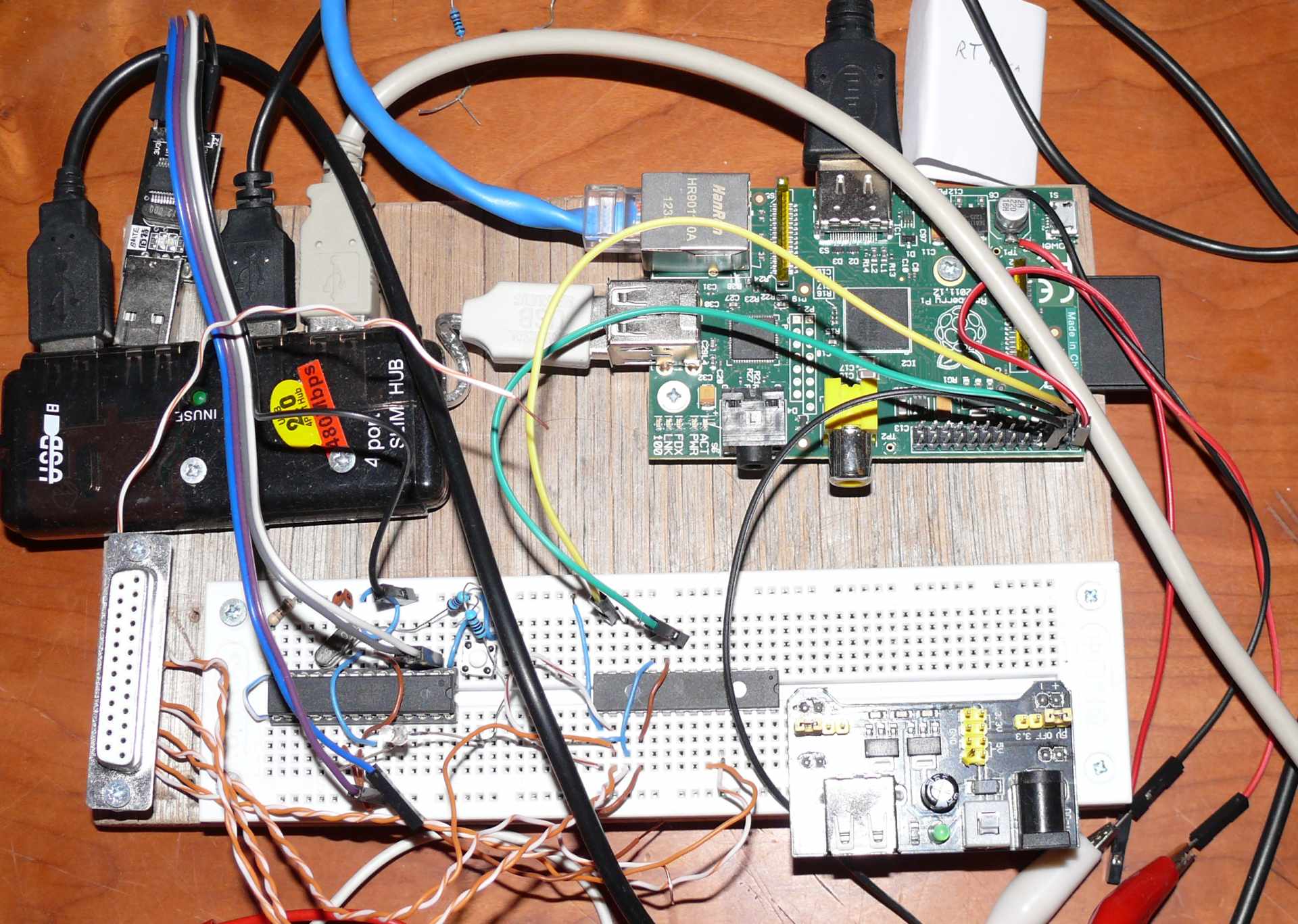

03 Jan 2013 01:34 #28331 by mungkie
Replied by mungkie on topic EMC2 running on Raspberry Pi?
Well as usual I have not managed to do anything I hoped, but I decided I should at least try and release something in the hope it will encourage other to do some hacking.
below is the driver I used for the video I made (posted in august on this thread I think), the driver has been updated as the gpio has changed in the latest 512mg rpi boards
// copyright mungkie 2012
/* MCP23017 pinouts
GPB0 			01[	U	]28 GPA7
GPB1			02[		]27 GPA6
GPB2			03[		]26 GPA5
GPB3			04[		]25 GPA4
GPB4			05[		]24 GPA3
GPB5			06[		]23 GPA2
GPB6			07[		]22 GPA1
GPB7			08[		]21 GPA0
Vdd			09[		]20 INTA
Vss			10[		]19 INTB
NC			11[		]18 /RESET
SCL			12[		]17 A2
SDA			13[		]16 A1
NC			14[		]15 A0
basic wiring for output....
pin 12,13 to rpi i2c port
pin 10,15,16,17 to ground (15,16,17 = set address to 0x20)
pin 09,18 to v+ (5 volt)
all other GP pins are wired as required to control your output hardware (steppers?)

03 Jan 2013 02:01 #28333 by mungkie
Just thought I should show the breadboard setup I have done, the mcp23017 is same as on my original soldered protoboard but there is also an atmega 168 which I have been experimenting with.
