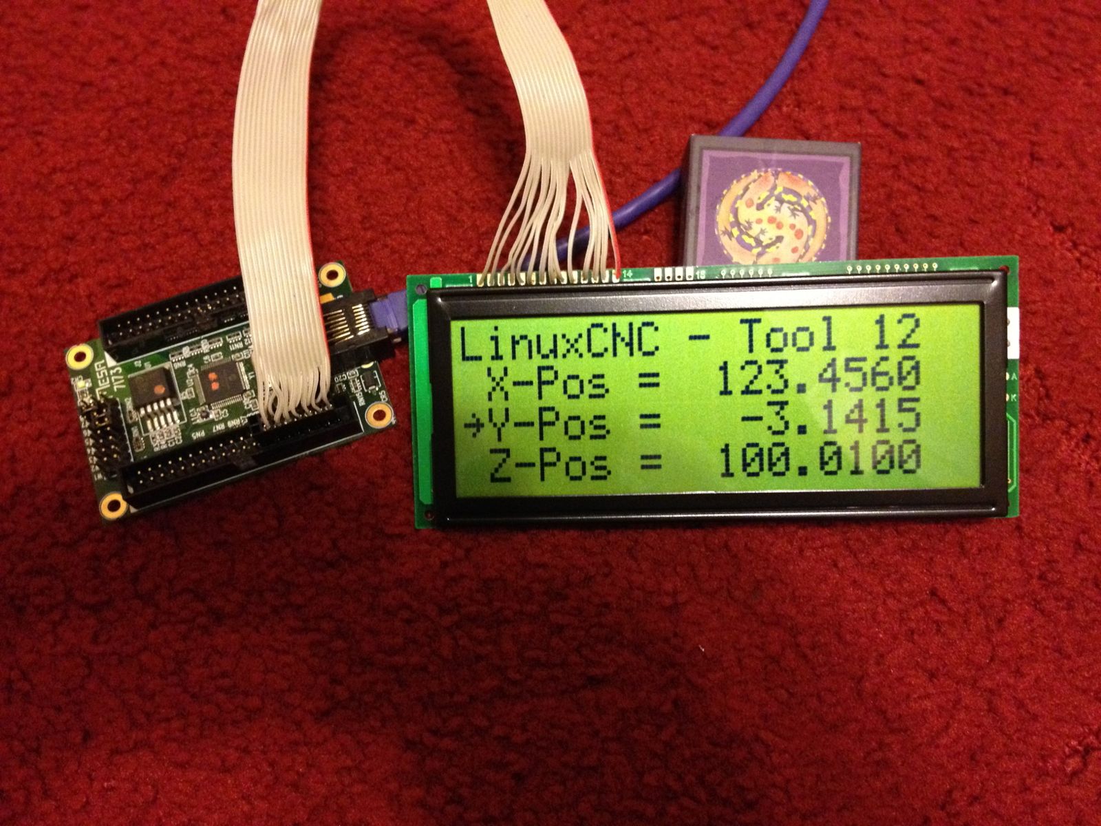

31 Oct 2012 16:49 #26130 by Miselph
Replied by Miselph on topic Re:Arduino I/O with Linuxcnc
I am using a MESA 5i25 - 7i76 combo, so I do in fact have enough inputs to wire the pendent directly into the 7i76, I even have an encoder input available.
However I wouldn't be able to display the machine position on the pendant that way.
31 Oct 2012 16:56 #26132 by andypugh
Replied by andypugh on topic Re:Arduino I/O with Linuxcnc
The 7i73 (plugs into the RS422 port on the 7i76) might be a simpler solution. We even have an LCD HAL component now:
