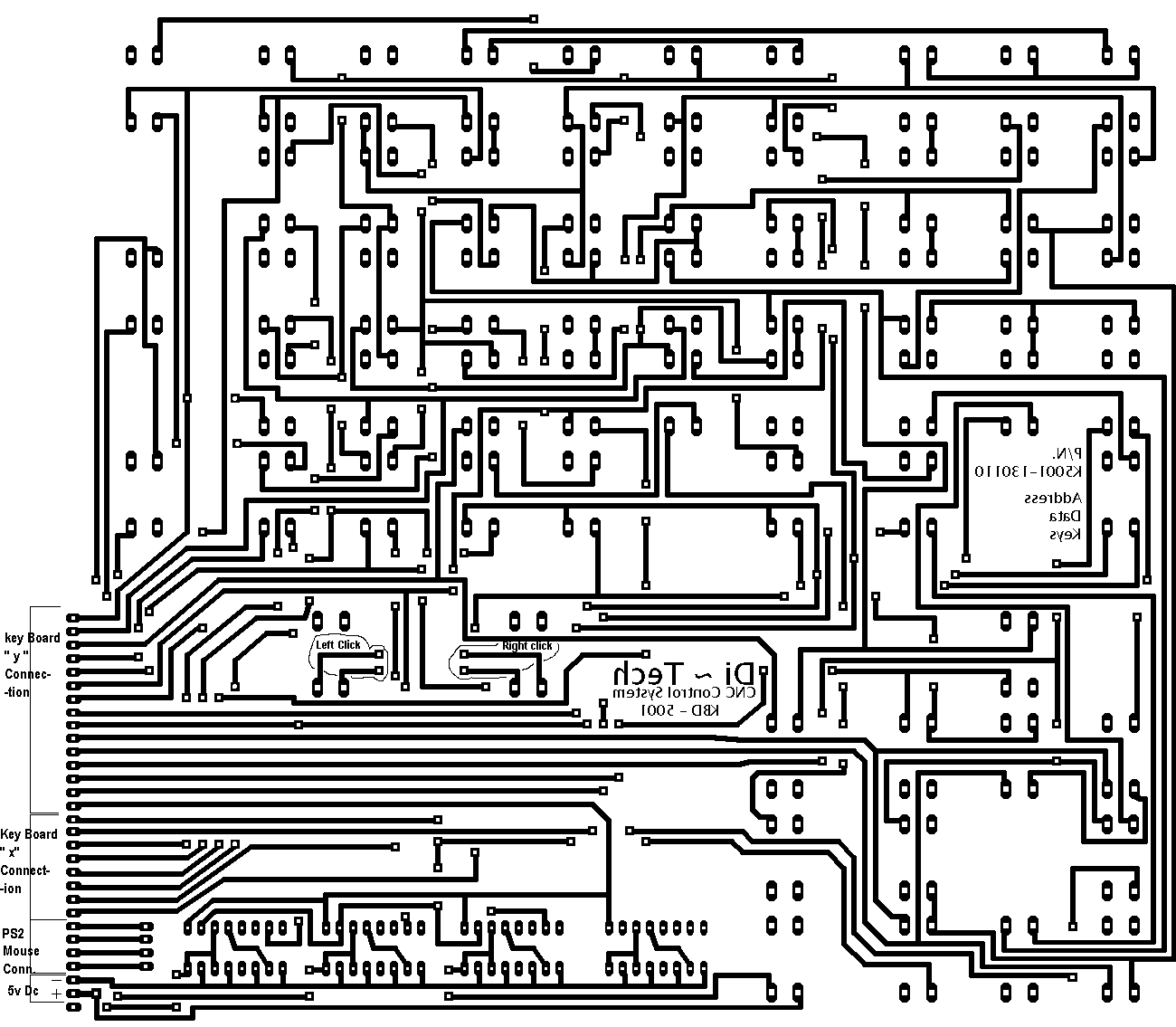

by ditechcnc
Custom Made Keyboard was created by ditechcnc
linuxcnc
custom keyboard
custom keyboard

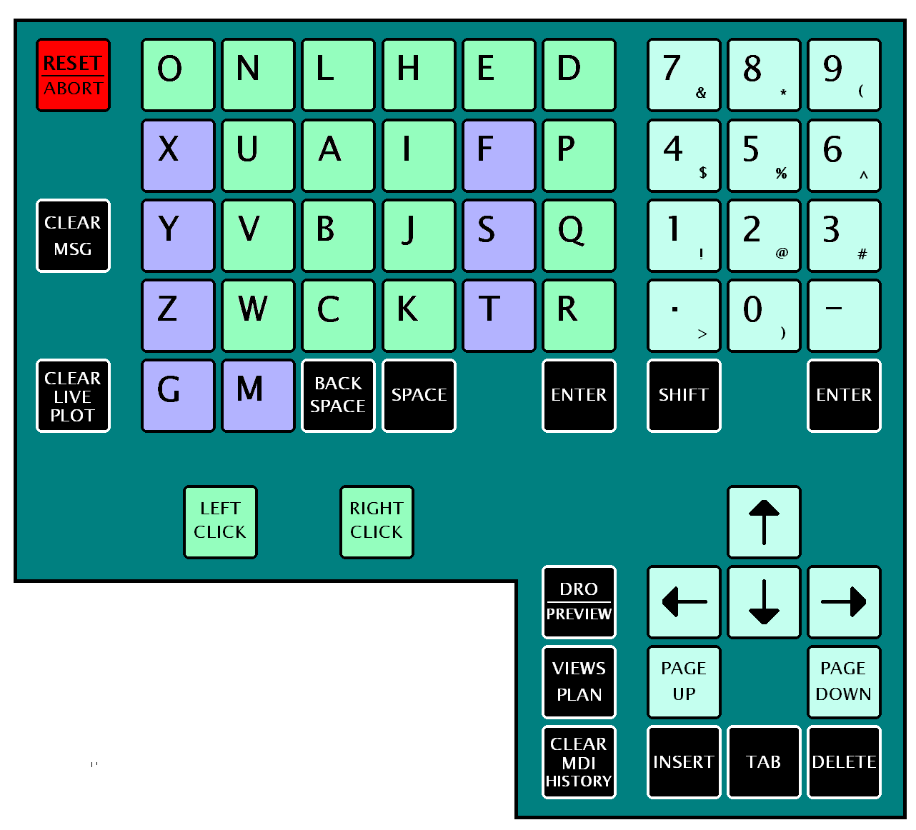

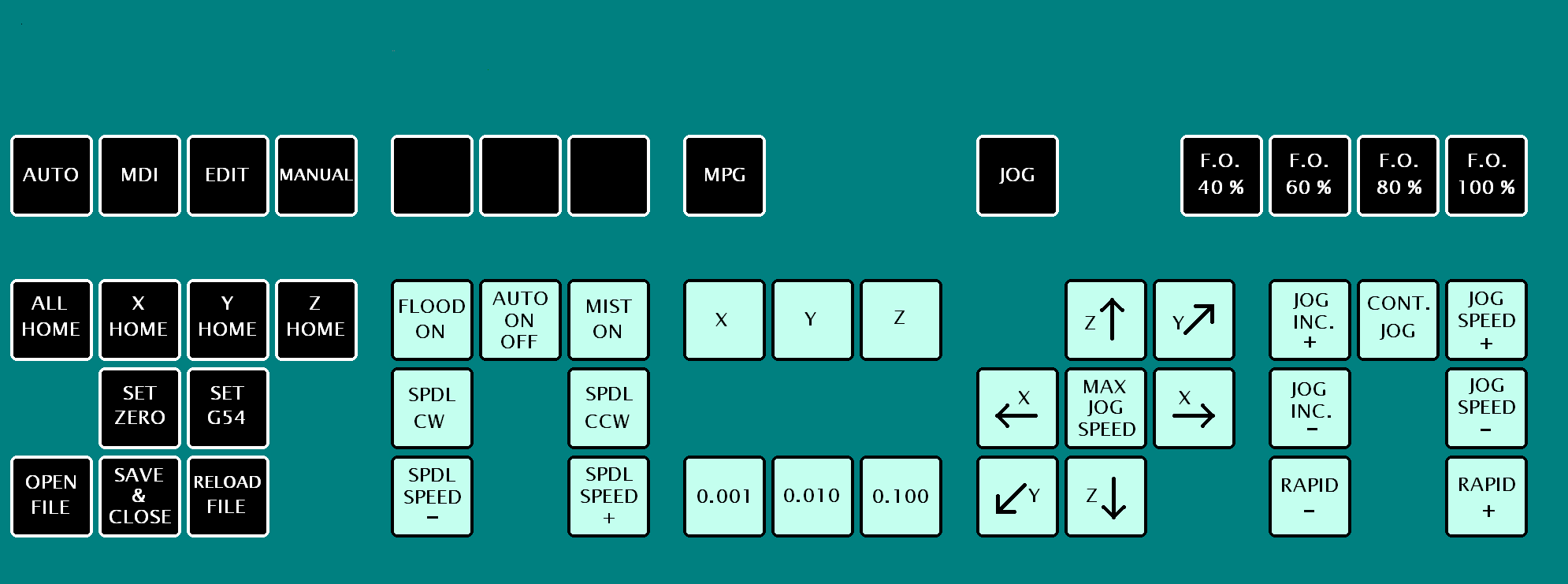

03 Mar 2013 01:59 #30775
by ArcEye
Replied by ArcEye on topic Custom Made Keyboard
Looks interesting
Can you tell us a bit about how it is connected up to Linuxcnc.
Is it all through keystroke emulation or are there any direct hal connections?
regards
regards

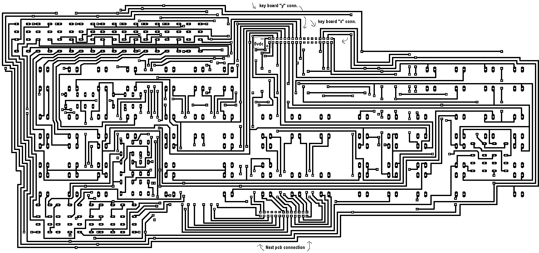

Used IBM KeyBoard
USB / PS2
PCB
Used Old Laptop
PS2 Mouse Pad
USB / PS2
PCB
Used Old Laptop
PS2 Mouse Pad
Last edit: 04 Mar 2013 17:57 by ditechcnc.

06 Mar 2013 19:42 #30962
Replied by andypugh on topic Custom Made Keyboard
The Mesa 7i73 supports matrix keyboards directly into HAL. It only handles 8x8 matrix size max, though. And there isn't currently much you can do with the data in HAL, but that just needs a HAL component that I am going to start tonight.
If you connect via USB then you can use hal_input to get the keypresses into HAL, where they can be used to jog directly, rather than "keyboard jogging" which isn't as reliable.
