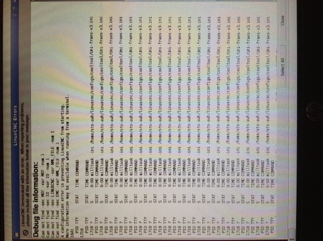

Hi everyone,
I have a problem with this PC.
SKU-No.: AT496AV
processor: AMD Phenom II X4 B97
I tested this PC - booted the PC from the Live CD (10.5) and linuxcnc works well. After that I installed the system (without network connection) on the HDD, reboot and:
Now when I start linuxcnc the software didn't start. When I start the latency test, the windows open, but the test didn't run.
Than I boot the PC again from the LiveCD, know booth work.
The problem is only if I boot from the HDD. The crazy thing is, that some time (1 of 20 boots or so), the software runs without problem.
What can be the problem?
I'm sorry I didn't have the debug.txt and linuxcnc_print.txt files, it was not my PC. The owners send me only pictures of them.
I hope somebody have a good idea

Can you rotate the photos? My neck won't bend that far...
What does uname -r report when it does not work booting from the HD?
John

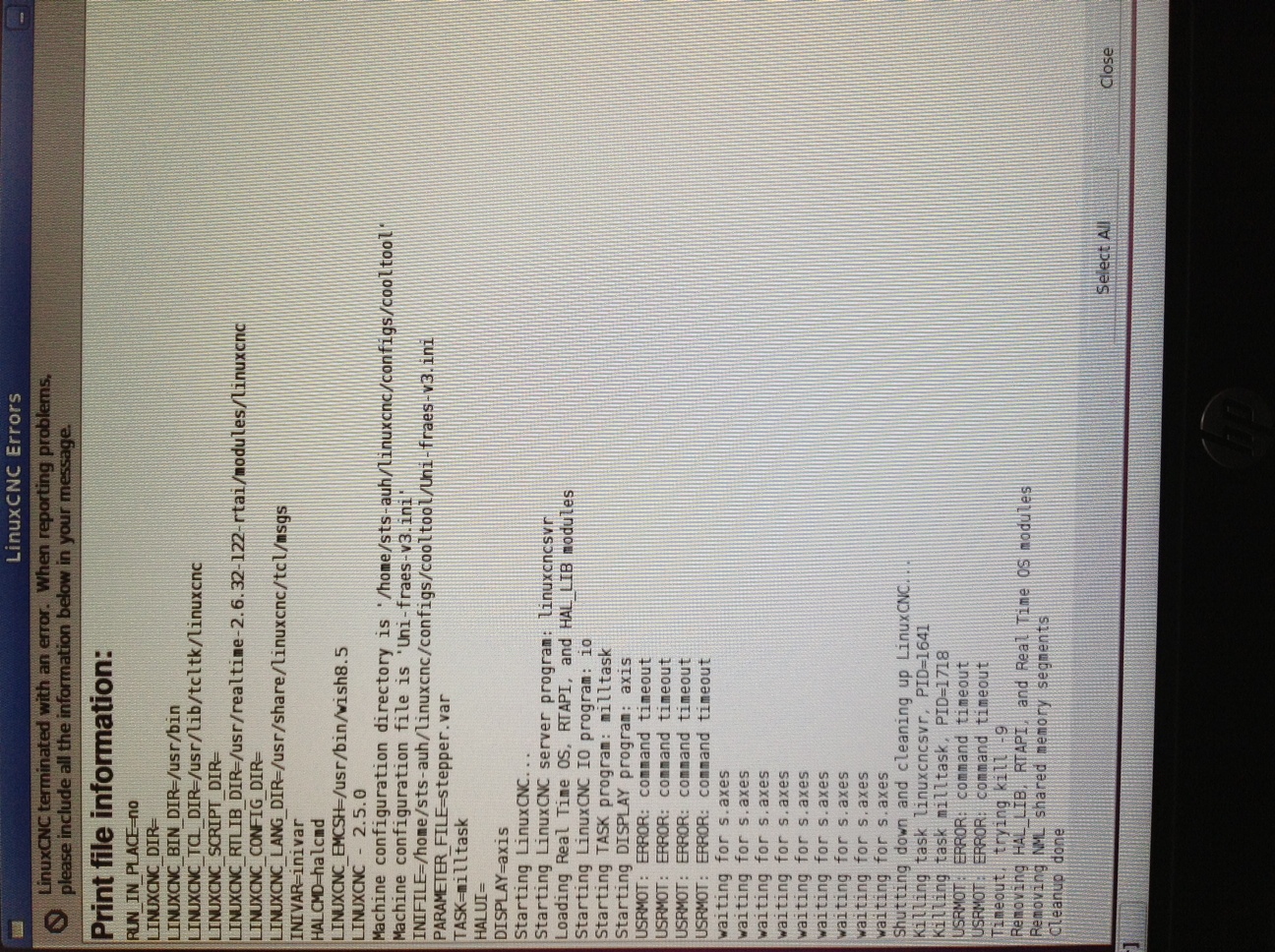

- ArcEye
- Posts: 25
- Thank you received: 758
25 Mar 2013 23:18 #31858
by ArcEye
You also need to post all your .hal and .ini files (easiest to zip the whole config folder)
There is no explanation where these came from or what they are for.
The most obvious suspect is that they are from an earlier Linuxcnc version which is not compatible.
Are you running the exact same configuration each time? Both from CD and on HDD?
Don't see how you could have been the first time, when you had nothing installed on the HDD?
Replied by ArcEye on topic Problem with "HP Compaq 6005 Pro SFF PC"
The print shows 2.6.32-122 ( I downloaded the images and rotated them, my neck doesn't twist that far either)What does uname -r report when it does not work booting from the HD?
