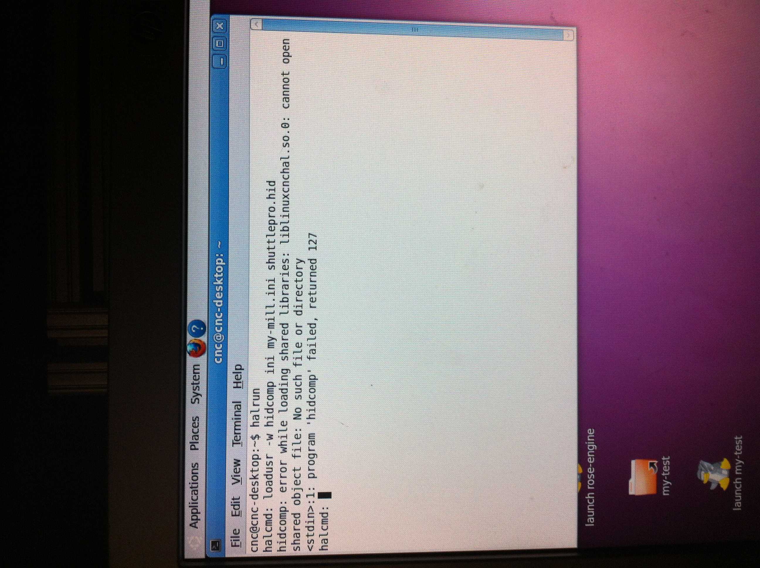

Well, when I run the hidconfig, it found my device, loaded the table with the right number and style of controls. And when I push the buttons on the ShuttlePro, the corresponding led on the left side of the table lights up. And when I put "loadusr -w hidcomp INI my-mill.INI shuttlpro.hid"(the last two are my file names) in my hal file, EMC loads without error.

18 Apr 2013 23:25 #32887 by m8298
Replied by m8298 on topic contour shuttle pro as EMC pendant
Ok, so I tried that and apparently it's not loading hidcomp. I just don't understand why. See attached photo.

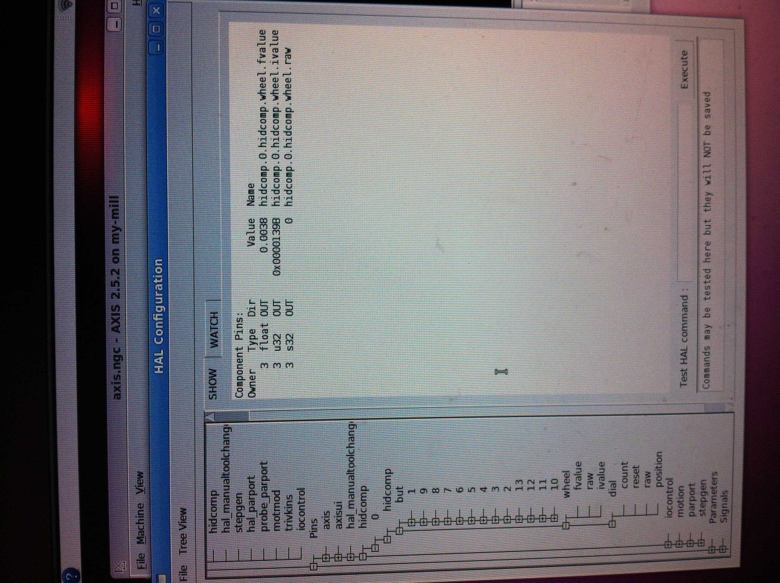

19 Apr 2013 01:15 #32893 by m8298
I am a little embarrassed, I figured out (with Franks help) why the pins weren't loading. I had EMC 2.4.6, and I had the latest hidcomp. Now that I updated to the latest version of LinuxCNC, it loads the pins just fine. Now I just need help understanding how to do the net commands in Hal to link the pins. I have attached photos of the pins in "Show Hal Configuration."
19 Apr 2013 12:35 #32906 by andypugh
Replied by andypugh on topic contour shuttle pro as EMC pendant
Open a terminal window. With LinuxCNC open, type
halcmd show pin
Copy and paste the relevant part of the output.
Photos of the screen (rotated through 90 degrees) are not comfortable.
