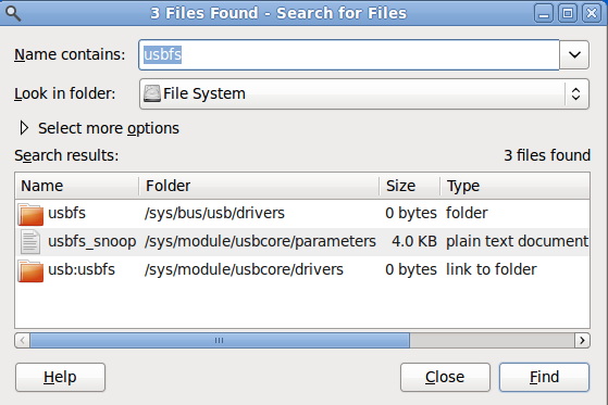

Here is what a search for usbfs found. Now what?

/sys is a virtual filesystem a bit like /proc, that is just where it is mounted.
Reading on this a bit more, I don't think you are going to be able to do anything about it if you keep the touchscreen driver.
Ubuntu 10.04 does not provide usbfs support, which previously would have been mounted at /proc/bus
So there is no kernel module to unload
The libusb library is a wrapper for usbfs, so the Touch Base driver files will be mounting it to provide the services it needs.
The other way to get USB devices working is through udev rules so that it is recognised.
This presumably does not provide the usability that is required or they would have taken that path
If you have to use the driver and the driver authors cannot correct whatever error is being complained of, you may just have to keep your logs as tight as possible
through logrotate etc
I would go back to them again and ask from a position of improved knowledge, how you are supposed to use their drivers,
if they generate unlimited error messages in use and create huge error logs.
They can't be unaware of the situation, they know how their drivers work and that they use usbfs.
Good luck

Thank you for your help. I will contact Touch Base again and see what they say and will post back with what I come up with.
