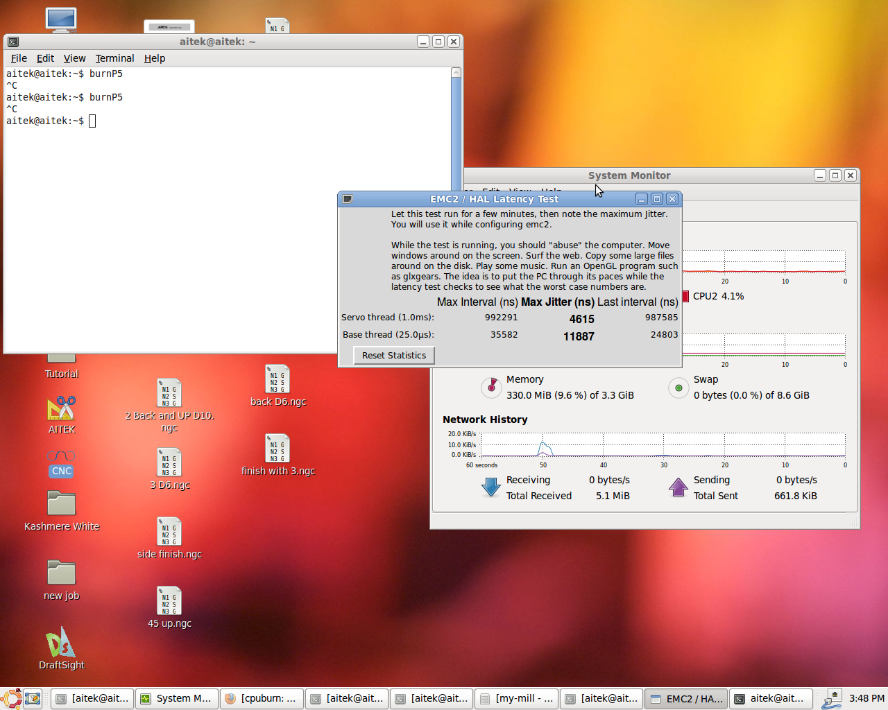

17 Aug 2013 15:19 - 17 Aug 2013 15:47 #37778 by grandixximo
Replied by grandixximo on topic New computer for linuxcnc
New PC tested and it has good latency with some tweaks.
After the tweaks when if i only open the test and nothing else and keep it going for an hour or so i get around 1000uS base thread max jitter, then moving stuff open a few glxgears, draftsight firefox all working at the same time for 20 minutes, and i get around 5000uS on max jitter Servo thread and 8000uS max jitter Base thread, sweet.
I did an over stressing test with burnP5, and glxgears opened in a big window, which make both cores at 100%, and the most i got was around 12000 max jitter on base thread. which i think is excellent for a worst case scenario.
So i think the results are nice, let's talk about the tweaks, i have SMI active, i still haven't try to disable it, i disabled isolcpu, so i'm working with both CPU.
At first i was getting 18000uS max jitter on base thread with normal use, then i went on the bios and disable everything possible on advanced CPU control, and that did the trick, now my worstest case scenario is 12000uS, which i think will probably never happen to have both CPU at 100% when working only on linuxcnc.
the computer is custom build with this parts.
CPU intel G860 3Ghz dual core
4GB RAM DDR3 1333Mhz on a single stick
H61M-S2PH Gigabyte motherboard, it's a Micro ATX, which is just a portion bigger of the Mini ITX like the 525 and 945 from intel, and it's sitting in the same box i had for the Mini ITX, i just have more PCI now, which is sweet i can get 5 parports on this thing if i wanted!
i'm cooling the CPU with the standard CPU cooler. i'll see if that is enough to keep it cold, i did disable all default cooling features from bios, right now it's a good time to test because where i'm staying it's 40 Degrees celsius!
motherboard+CPU are probably twice as much as the 525 was, but really it's a good trade for me, everything in the system is so much snappier, installations, opening programs.
And CPU and motherboards are easier to find right now, and i think the H61 chipset is going to keep going for sometime, and for what i have seen they all look pretty good with linuxcnc, i mean i was looking at an MSI motherboard with a G850 CPU, i bought a gigabyte motherboard with the G860 and it's looking just as good.
Draftsight wich i use a lot to design the stuff i'm going to cut, is still a bit laggy (i think the drivers for the intel integrated graphic on ubuntu 10.04 are not the best, even a big glxgear cannot round smooth), i'd say it's the same experience as with the 525 and 945 boards, I'd like to add a small graphic card with VGA that doesn't bother the CPU too much any suggestions?
can anyone upload this results to the wiki, or explain me how to do it?
Last edit: 17 Aug 2013 15:47 by grandixximo.
