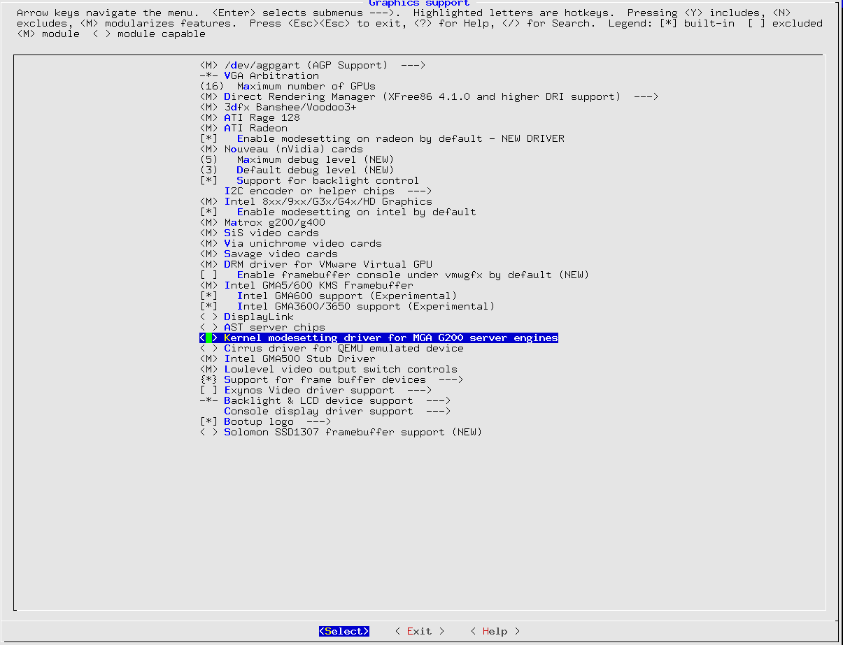

This bug report is essentially what you are reporting
lists.debian.org/debian-kernel/2013/03/msg00482.html
That user was also stuck with 800x600 max resolution
The kernel config options for CONFIG_DRM_GMA500 and CONFIG_STUB_POULSBO are present in the 3.5.7 kernel I am currently using but not the CONFIG_DRM_GMA3600 option
The GMA??? options did not emerge until kernel 3.3.
I have downloaded kernel 3.8 to see if the CONFIG_DRM_GMA3600 option is present in that
It is, as per screenshot
If the module builds OK I can try building a rtai version of the kernel with the modules enabled and see what happens
magma realtime and the testing version of Linuxcnc will run on that kernel
No promises, but if it seems to pan out, I will give you a shout to test it, I don't have any cedarview chipped machines, thank goodness.
For now though your best hope seems to be using a generic driver and settling hopefully for 1024x768 or whatever it will offer

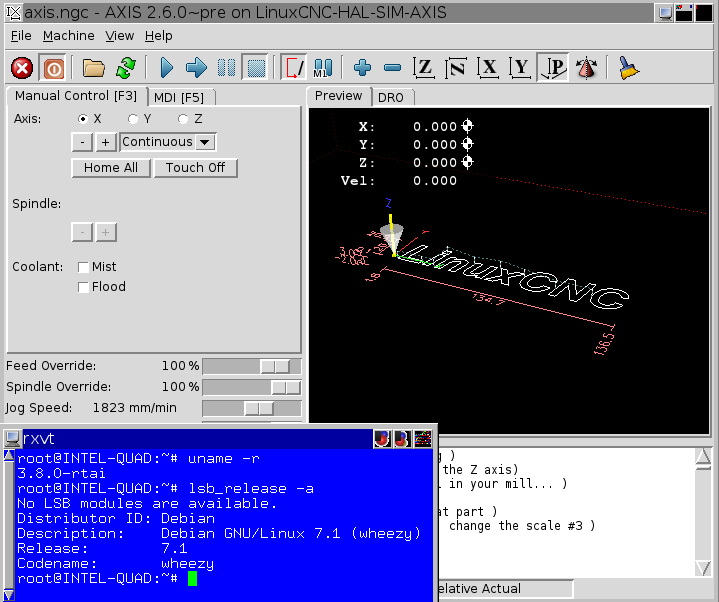

OK, I have built a realtime version of kernel 3.8.0 and built RTAI and the testing version of lunuxcnc against it
There is a gma500_gfx.ko module, plus the poulsbo.ko module and support for GMA600 / 3650/ 3600 should be built into the kernel
That was on Debian, just need to repeat it on Ubuntu 10.04 and will have something for you to test, once it is packaged.
regards
