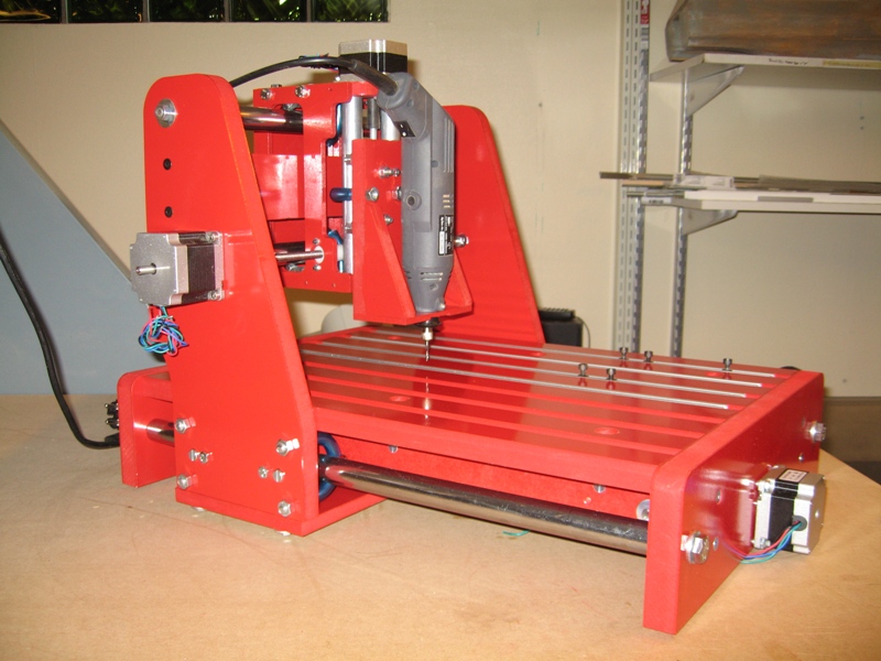

I want to install on an
Intel NUC
. Will it run?

I have decided on an Intel DN2800MT . It has been used with Linux CNC. I will try to install Debian 7.1 with RT patches. The board has an onboard parallel port. I will use it with my Lillasyster:
using the breakoutlight r1b:
I´ll start a new thread with my experiences.
