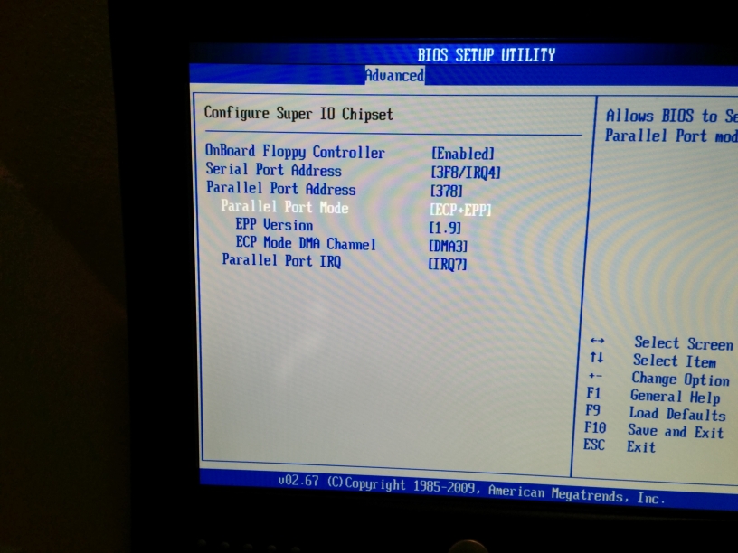

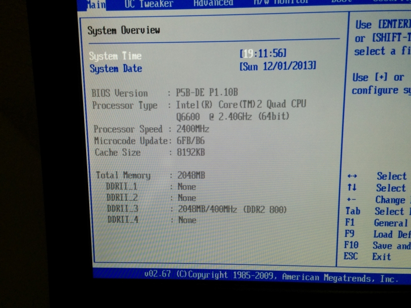

It's my first time using LinuxCNC after some months of GRBL. However everything went surprisingly smooth: I installed it on my old PC with an Intel Q6600 and an Asrock P5B-DE MB. 4 GB of RAM and onboard Parallel Port, all other Hardware removed. As a motor driver I'am using this infamous 4xTB6560 China driver but mine has another pinout .
It has an enable pin for every axis which I am trying to trigger with
in my custom.hal and for X and Z that works just fine! Pin 17 on the other hand just puts out 1.55 V when High.
That seems to benough to be sensed by an Input Pin (Connecting 17 to an Input, parallel port tester behaves just as expected) but not for the driver board. The Y Axis just wont move.
Of course there are plenty of possible workarounds like rewiring or using the 4th axis driver as Y but for elegance's sake I was hoping some configuration issue to be the cause.
Here is my bios and parallel port Settings, in case it matters:

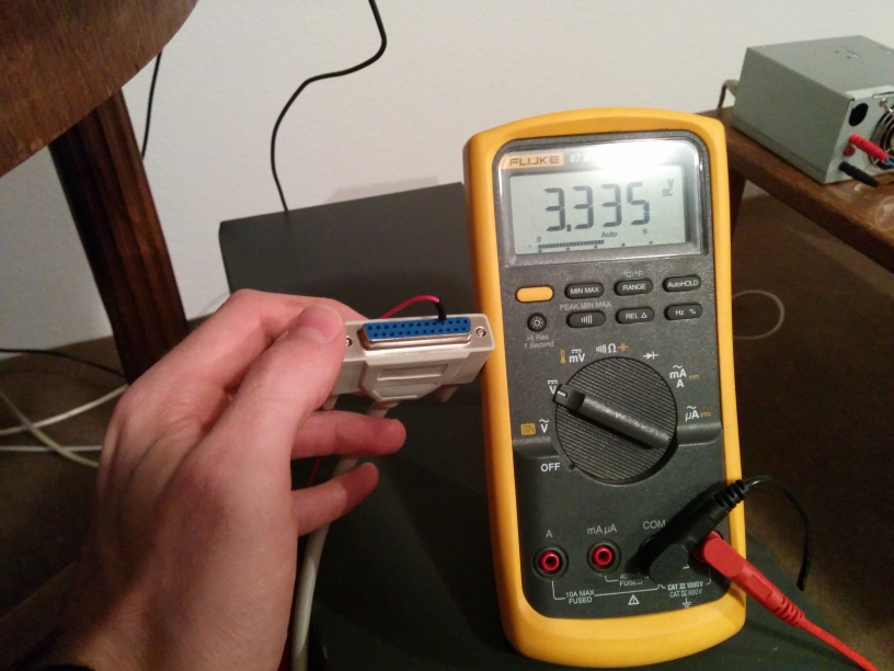

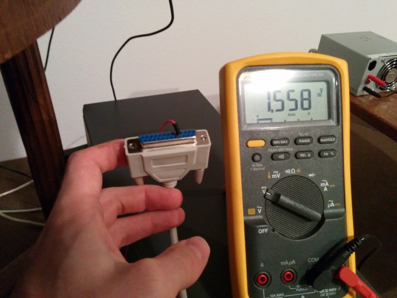

So the same problem of low voltage occurred when using the pci card. How strange? I couldn't believe it, so I went "low level" and used a C Program with
parapin
to test it again. Error remains ... you get an idea? I finally did (after 2 days of fighting this trivial problem ...)
I measured the voltage driectly at the connector of the PC and guess what: Turns out it was a broken cable all along
If I used that salvaged one from my "old cable box" I might have tried that earlier but the defect one was brand new. Bummer!
