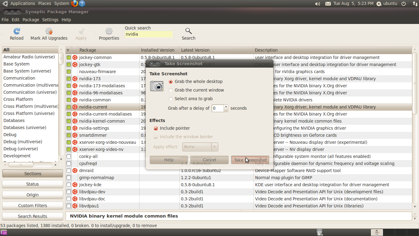

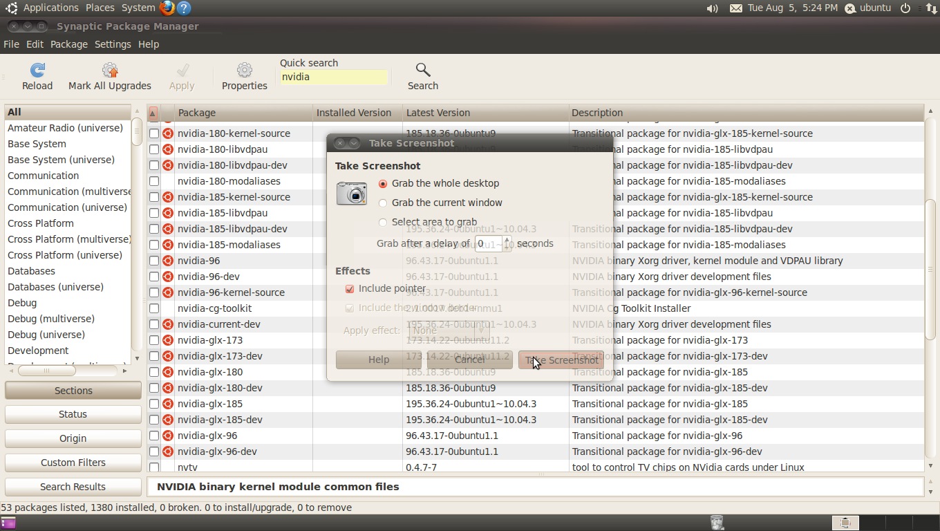

- hickbooz
- Posts: 7
05 Aug 2014 22:21 #49540
by hickbooz
Replied by hickbooz on topic RTAPI: ERROR: unexpected realtime delay on task 1
I tried to do it, but apparently there is no nvidia-glx installed.
I listed below the installed packages related to nvidia. There is a lot of nvidia-glx listed, but none of them are installed.
There is some other package that I have to unistall?
Thank you!
Thank you!
- ArcEye
- Posts: 34
- Thank you received: 240
06 Aug 2014 08:30 - 06 Aug 2014 08:30 #49552
by ArcEye
Replied by ArcEye on topic RTAPI: ERROR: unexpected realtime delay on task 1
I dont use Ubuntu, apparantly they were not content to have the same packages as Debian, so just had to change names etc.
Last post here seems to get to the root of it, just make sure you check nouveau is not still blacklisted before you reboot, earlier post covers that.
askubuntu.com/questions/206283/how-can-i...ia-driver-completely
regards
