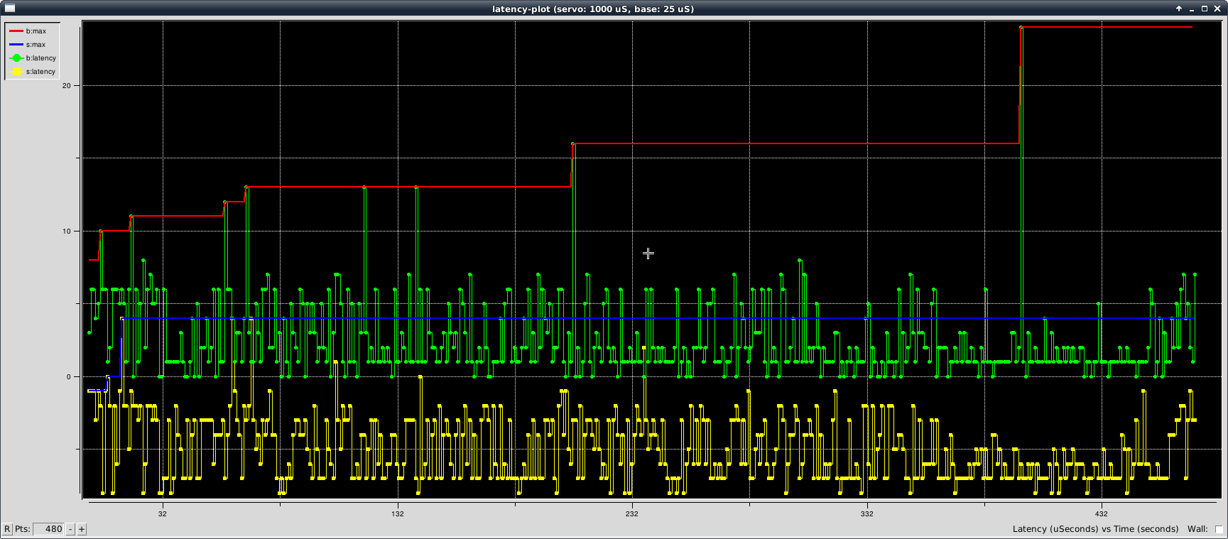

Mainboard just arrived.
I'm doing some test using latency-plot.
I have some sporadic spikes (most at the beginning of the test), the biggest one is about 25k but the average seems good.
I ran glxgears, few videos on the web (most are flash),..
Do you think I have to work on SMI issue to eliminate spikes or they are acceptable for a Mesa 7i43?

25 usec is fine for medium speed software stepping and not an issue at all with a 7I43
At a 1 KHz base thread and RTAI, LinuxCNC wont complain until you get to 200 usec of delay.
The standard stepgen driver is bit picky about jitter greater than 100 usec or so but it can be worked around
by setting the stepgen accel to about 20% more then the trajectory accel (this is standard in pncconf and the sample files).
With the latest DPLL firmware, and controlling the stepgen with a standard PID loop,
more than 400 usec of jitter is acceptable on a 1 KHz thread.
(this reduces the sampling jitter of the stepgen position to the 50 ns region)

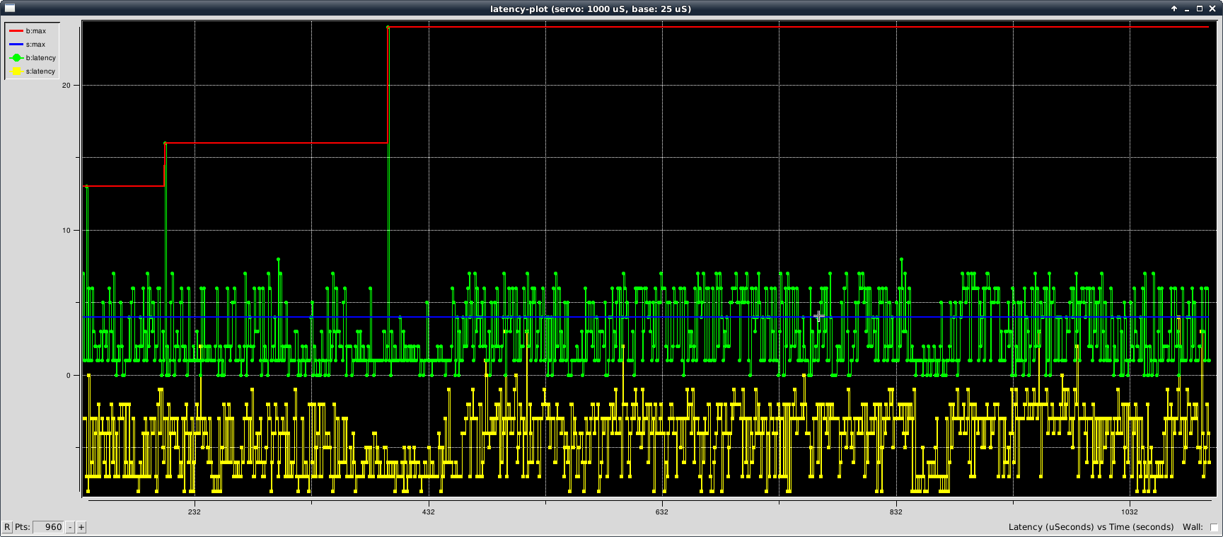

OK, after another sanity check, I found that I had in fact left the CPU "C state report" function enabled in the BIOS, which from the manual is quite clearly the CPU power saving functions!
Switching that off and with ISOLCPU= 1,2,3, the maximum jitter on the base thread was 7138 and 4158 on the servo after a morning out at the supermarket, getting the car washed etc (about 3 hours) with three glxgears running.
I just played around some more with ISOLCPUs and found that 2,3 is even more promising, only showing 4226 & 3452 jitter so far for base and servo. I'll leave this running for a few hours to make sure that nothing else creeps in, but so far this board is now looking very good.

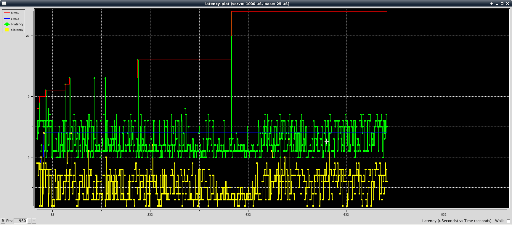

I purchased the J1900-D3V and it is running great - i have the IOLCPUS=2,3 and am now seeing the same numbers you are: I am getting a base thread jitter of 5367.
I tweaked more of the bios settings and am getting some great numbers.
