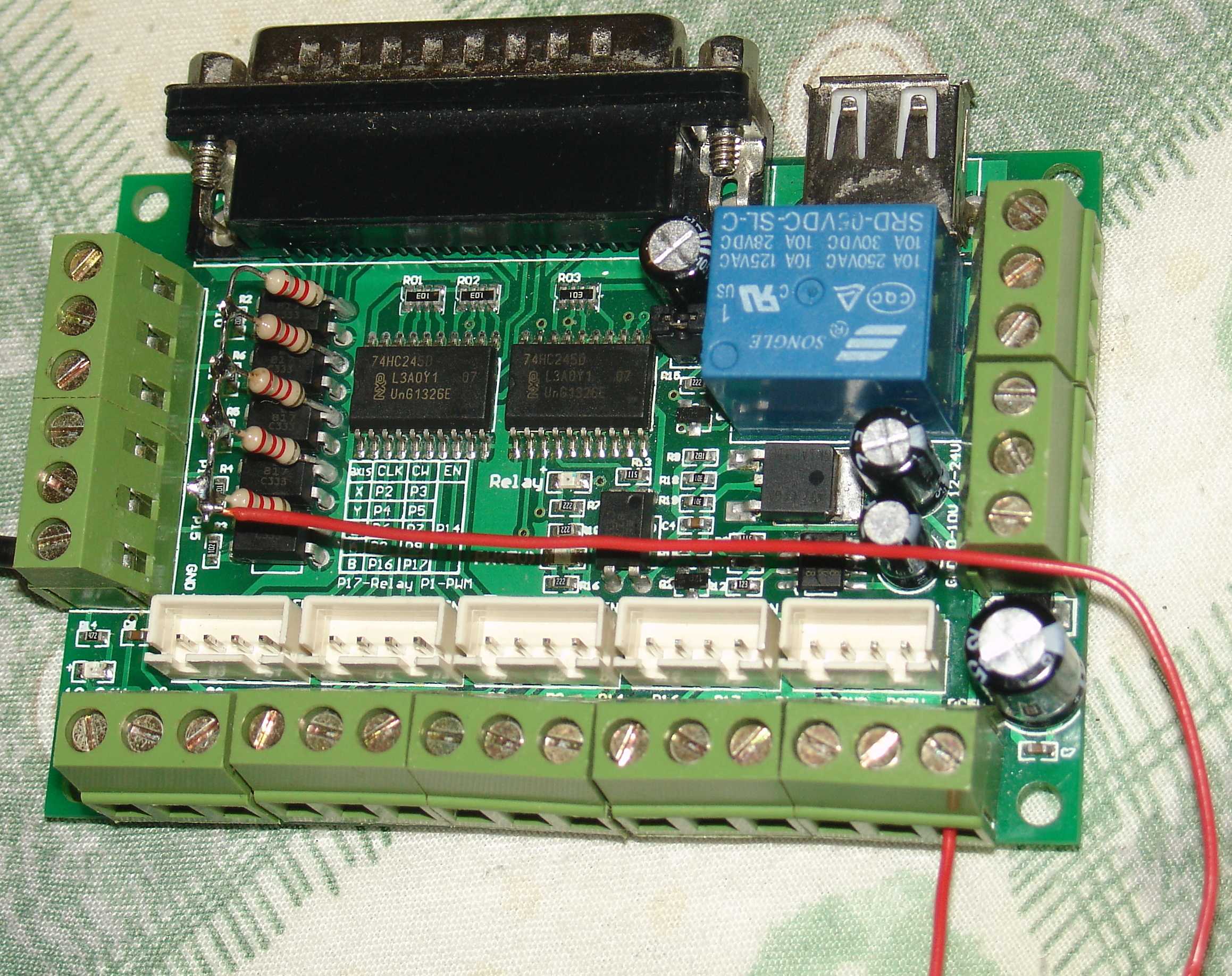

@PCW Is better to put pullups to +3.3V that is the high logic of outputs?
5v from usb -> 3.3V regulator (ldo) -> pullups -> input pins
Just tried this patch with 5v & 2.2k pullups and works fine to asrock Q1900M pro3...
