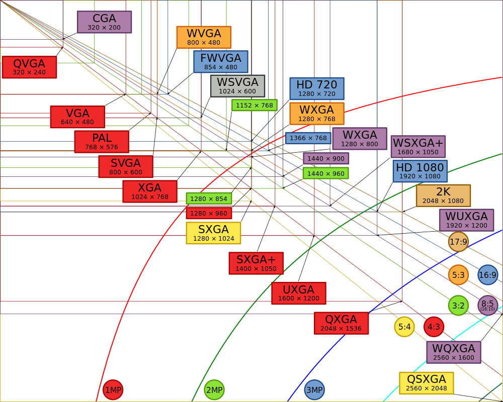

I was digging myself into a dead end... again....
Anyway, I deleted the "imaginary" modelines and modes from the ,conf and live with it.
Thanks for the heads up Arceye.

Stupid of me digging an dead end for a week.
I felt even more idiotic when I remember I can customise the gnome appearence just by changing the font sizes.......
So 1280x1024 works beautifully.
