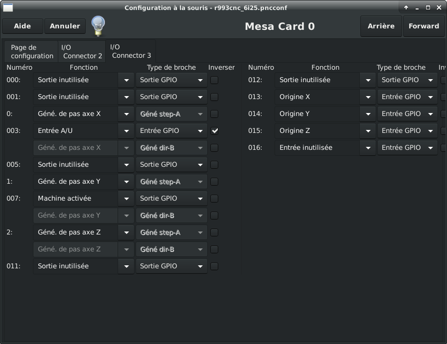

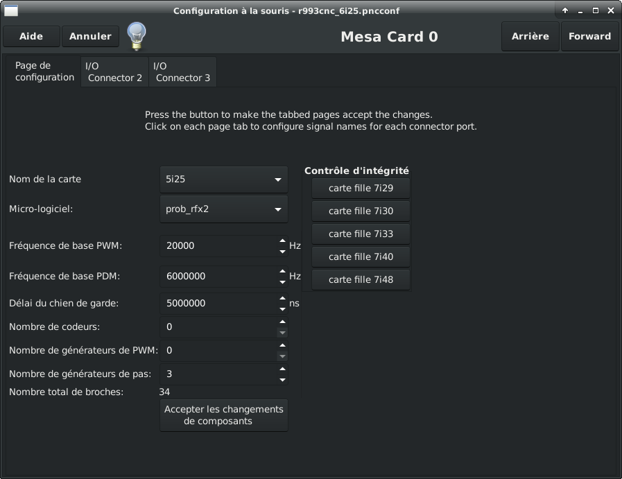

Could you please advise where to get any info how to setup this mesa 6i25 (except basic linuxcnc documentation)On an ASRock J3355B-ITX (celeron 2 cores) , I just add a MESA 6i25 to the config to solve latency problems and to remove stepping generation form the motherboard cpu. I have keep the same pinout as the parport.

Replied by tommylight on topic Asrock Q1900B-ITX
To setup Mesa 6i25, start PncConf from the CNC menu, choose Mesa 5i25, add other values, save.
Mesa 6i25 is the same as Mesa 5i25, but for PCI-E bus.

24 Oct 2022 08:27 #254884
by macsddau@linuxcnc
Flashed 5i25_prob_rfx1.bit into the 6i25 card.
copy 5i25_prob_rfx2 files to some places (don't know if it is necessay but that's work) :
Replied by macsddau@linuxcnc on topic Asrock Q1900B-ITX
I use 5i25_prob_rfx2 conf.
the 6i25 was available form eusurplus fiew weeks ago. A little expensive with vat and shiping.
- 5i25_prob_rfx2.bit => /lib/firmware/hm2/5i25/
- 5i25_prob_rfx2.xml => /lib/firmware/hm2/5i25/
- 5i25_prob_rfx2.pin => /usr/share/doc/hostmot2-rimware-5i25/
