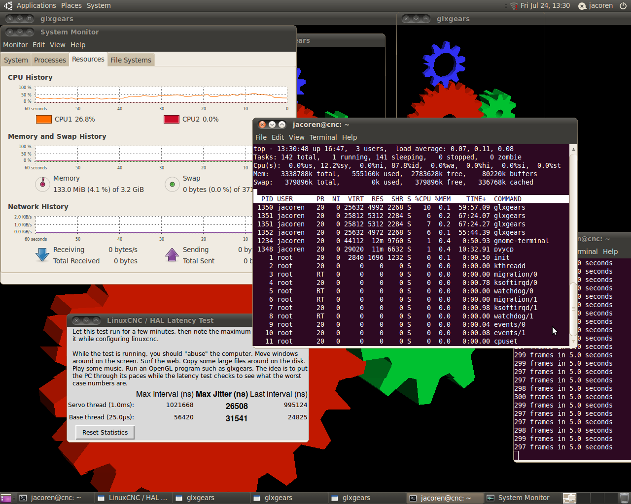

24 Jul 2015 18:49 #60881 by TheChosenOne
Replied by TheChosenOne on topic Intel D525MW - high jitter
After 16 hours of running multiple glxgears, system monitor and top command, maximum jitter equals ~ 32k. Is there another way of decreasing this value?
System is installed on a pendrive, can this is be a cause of problem?
24 Jul 2015 19:13 #60882 by ArcEye
Replied by ArcEye on topic Intel D525MW - high jitter
It certainly won't help
Use the rtai latency test as outlined in my FAQ
www.linuxcnc.org/index.php/english/forum...-the-latency-problem
Then you will be able to see when the spikes occur
The other test is a cumulative one and gives no idea when a spike occurred or what the underlying figure is.
If you had one high spike on drive access through USB, it would continue showing that figure for ever more
regards
