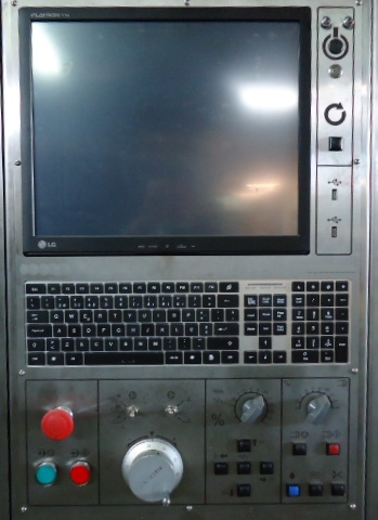

Hi!
Has anyone use B&R products before? Probably very pricey.
I really like the PC 2100!
Landcape 21" with buttons.
www.br-automation.com/fr/produits/pc-ind...units/5ap99d215c-00/
Portrait.
www.br-automation.com/fr/produits/pc-ind...units/5ap99d215i-01/

Unless you can get an absolute guarantee that the touch screen works with whatever linux you are using, don't even consider it.
A lot of touch screens are only supported by the latest distros and some not even then.
If they say it 'comes with drivers', they don't know what they are talking about.
It is probably a lot of money for a screen in a surround with a few switches in it.

After some digging.
B&R have support in the UK out of Peterborough.
The 21.5" with multi touch (currently beta support available in Debian) expect stable by end of year.
Preliminary material number: 5WI110200GC010-000
- Automation Panel 21.5" 1920 x 1080 pixels (16:9)
- Multi-touch (projected capacitive)
- Portrait format
- 2 push buttons
- RFID read/write unit
- E-stop
- Key switch
- IP65 protection
- Support arm mounted
- Flange on bottom
- Panel PC 2100
- Intel Atom E3827 1.74 GHz
- 4 Gbyte SDRAM
- CFast 32 GByte MLC
The buttons are all hardwired. The two push buttons are backlit with a single colour of Red or Green.
Approx £2.3k + VAT.

That would need checking up on, if only available for Jessie, that won't help you.
I am baffled by the radio frequency transponder ID unit, what is the point of that?
The actual 3M screen as a monitor can be bought retail for £1000.
I am sure it is nice, but wouldn't be my choice
regards

I would probably use the RFID for staff login/logoff to the cnc machine. That leads nicely onto my next question. Could you have a very simple browser window in Glade/LinuxCNC. I have a touch screen UI I have made for some of our other machines so we can see real time job sheets and upcoming work for that machine. Looks relatively easy. I might have a bash!

Next question. When a cnc program starts or finishes, could we trigger a URL in the browser window to let my database know a part has started machining and when it has also finished?

yes it's possible to trigger and do anything , you only need to program it
nice monitor , but far over priced for what it is
you could make your own far cheaper , after all we are engineers arn't we ....
from what i see it's all pnp , flat screen touch display , a small pc , power supply , and buttons and a case
rfid is standard on some sbc';s , but a plugin card is only a few dollars .

I'll try and find a header less sbc. I would like to make a sealed unit up with IP6X connectors for cables etc.
