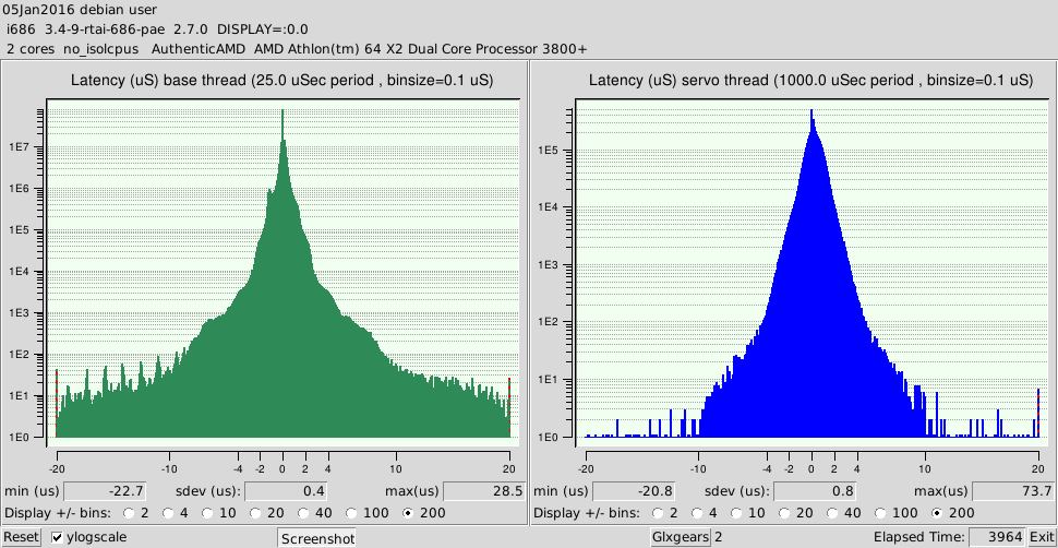

It went well for some time (2 gears and watching youtube videos), but then from time to time I got a peak up to 75ms
As one can see in the graph, it is relatively constrained, but we do have values "out of range". I tested quite long time and it never go beyond 75ms...

It is good enough for use with Mesa cards.
Do NOT install nvidia drivers, latency will get worse and you may have openGL problems.
regards
EDIT: I assumed you have your ms and us mixed up. No-one gets 75ms jitter normally.

07 Jan 2016 09:47 #68011
75 mS (0.075 S) is absolutely unusable. But 75 uS (0.000075 S) is perfectly OK with a Mesa card.

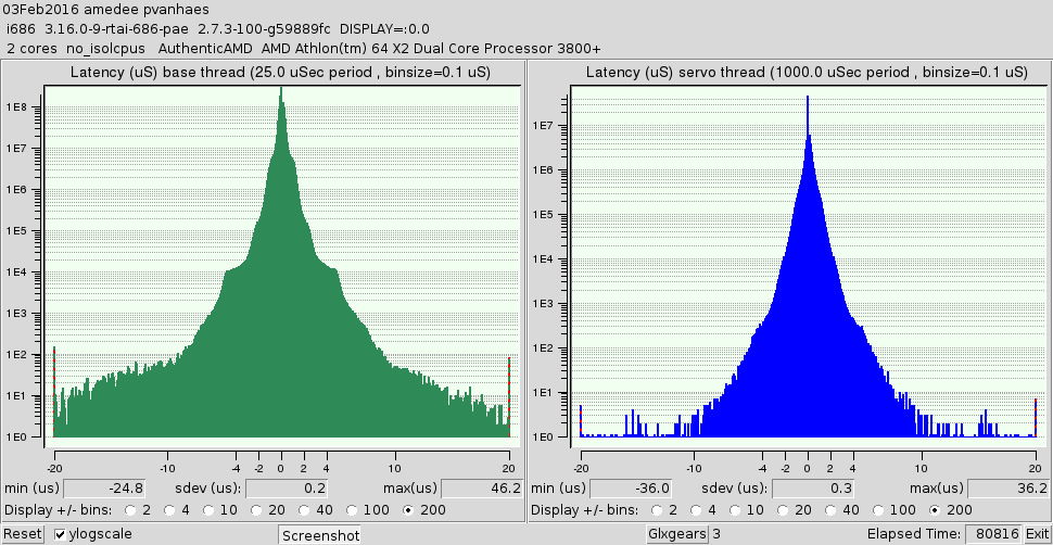

04 Feb 2016 18:09 #69596
by Amedee
Replied by Amedee on topic Old computer... Use it or ditch it?
Just for the record, I tested about all the combinations on local disk (instead of the live cd) with no real improvement.
Eventually I stripped the machine to the bare minimum (no floppy, cdrom, ...) and replaced the 13 year old IDE disks with an SSD.
With Jessie and the latest kernel it is looking now a bit better:
(Output after running 3 glxgears and playing Youtube channels for a bit more than 22hours)
In the meantime my 6i25 board arrived, so I'll proceed to the next step: (try to) get the real thing up and running!

05 Feb 2016 12:48 #69645
Replied by andypugh on topic Old computer... Use it or ditch it?
If you are using a 6i25 then your latency is more than adequate.
I have used software stepping on machnes with 50uS latency peaks with no problems.
